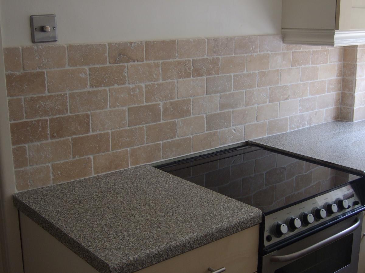

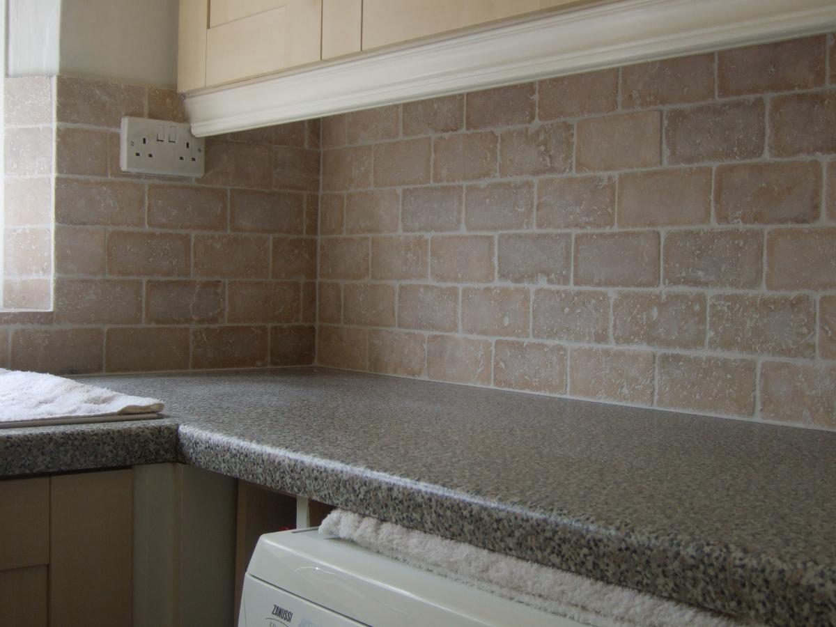

Thanks for your help, the job went really well and customer delighted with end result. Managed to get rid of almost all the paint and used Bal SPF after priming walls. Please see photos attached if I have uploaded them correctly.
Once again many thanks for the advice.

Nice job Ross, I would have done a few things different but the finish is all good, so well done.
Nice job Ross.. and thanks for sharing the pics..
A Tip for next time you do windows with none 90dgs reveal returns.
Mitre the edges to get rid of the square step edge, on square 90dg corners an overlap joint sits flush but on split angle joints like that it is neater to mitre..
Just a Tip for next time and a nice job you have made.. :thumbsup:
