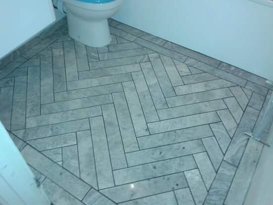

i cant get my head round it i want to do it like ali has done in that pic just without the boarder, but all need is the 45 degree of the triangle dont i?

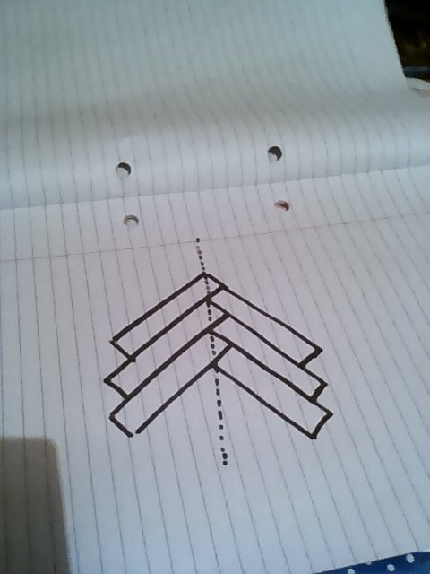

Do you just use one centre line ali? Or do you need one line each end of the tile? Seems it would be hard with just the one centre line if you know what i mean
And it wasnt every top right on the c line it was the top left of each tile if you know what i mean by that
Depends which corner you put your centreline through. Right hand tiles or in the pictures case left hand.
I just worked from that line out.

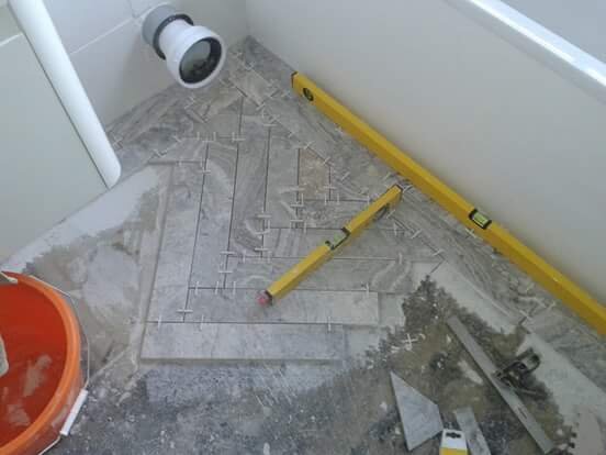

I'll see if I can find some progress pictures from that job.

Would be appreciated ali did you not find it hard just working to the one line? Seems it might be a bit hard as the tile isnt following the line on the run like

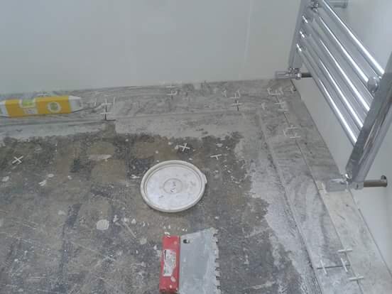

Not at all. Made sure my border was set in perfectly level and more importantly square. So as long as you line splits perfectly centre 50/50 all the way from one side to the other.
Set my first cut at 45 degrees to the line (or border edge depending on how you look at it) and marked through my tiles with my square as mentioned earlier.
As long as the centre line runs through the top point and the line marked on the tile with the square then it's perfect.
As long as your measurements are spot on!
Just to mention (and not to cause a row) but this is a 1.5sqm floor, not the 25+ deano did in a day on site. I did this in a day and tool the same if not more than what 25sqm on site would pay.
See I think I can't do site through simply not being quick enough. That's because I lean more to the smaller details of tiling. I really enjoyed doing this because of the accuracy and intricacy of the floor.
I cut all the stone down from bigger pieces. Admittedly these were done the day before on the wet saw but only took about an hour.
The 45's I marked and cut with the grinder on site. Polished once fixed, sealed, grouted and a final Polish.
