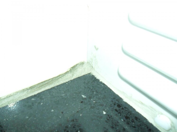

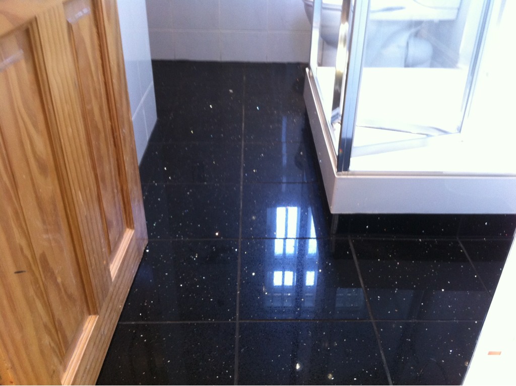

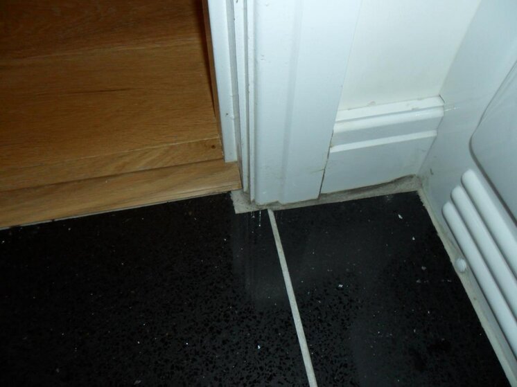

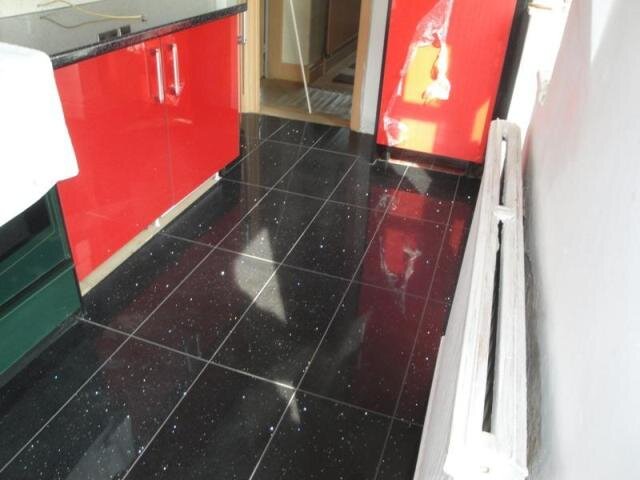

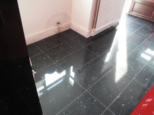

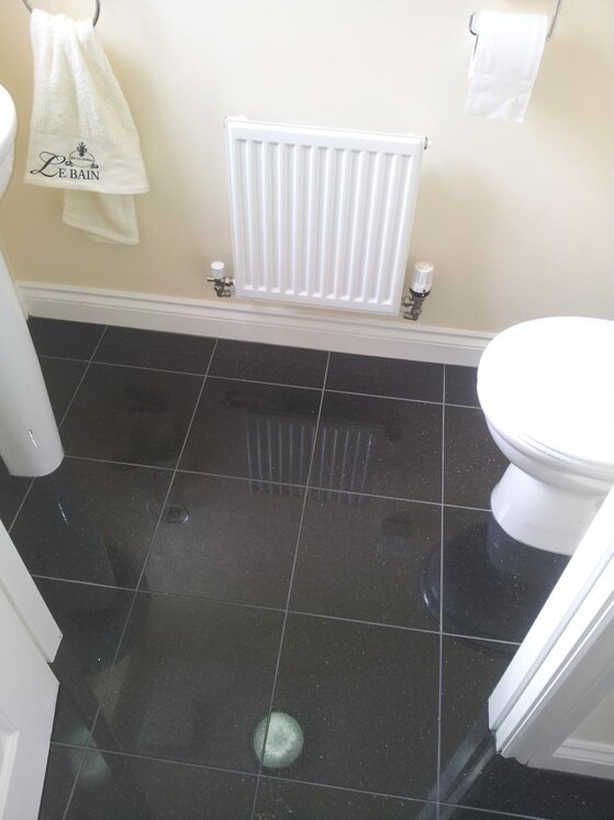

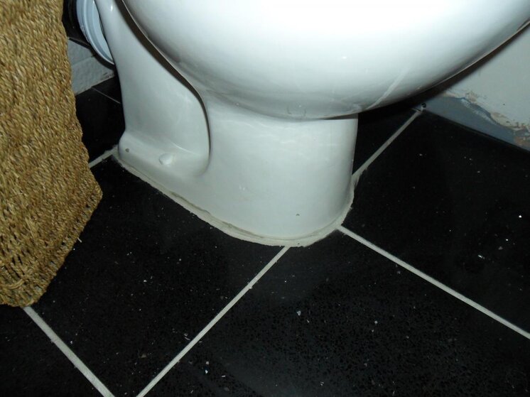

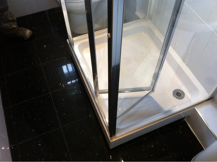

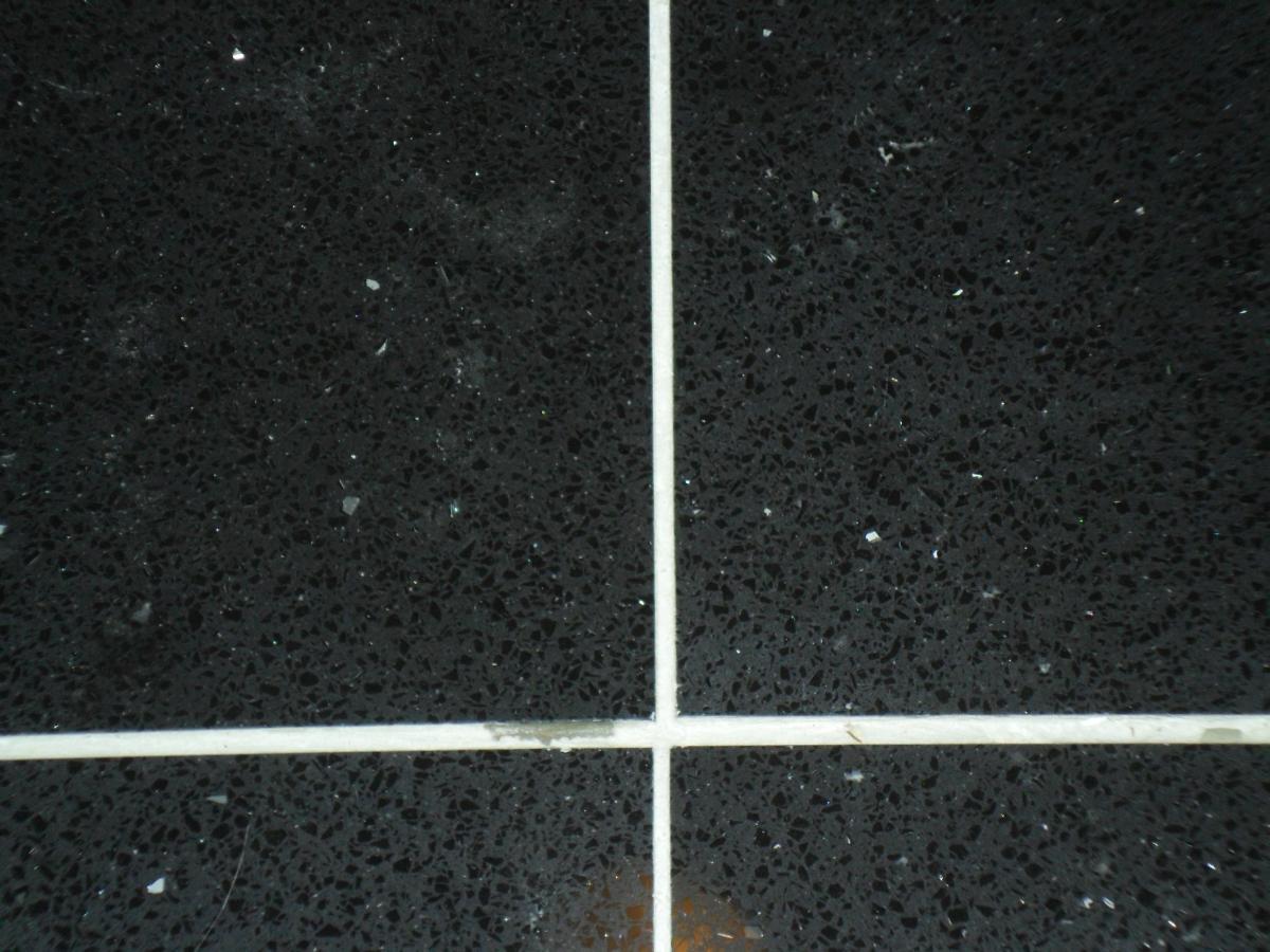

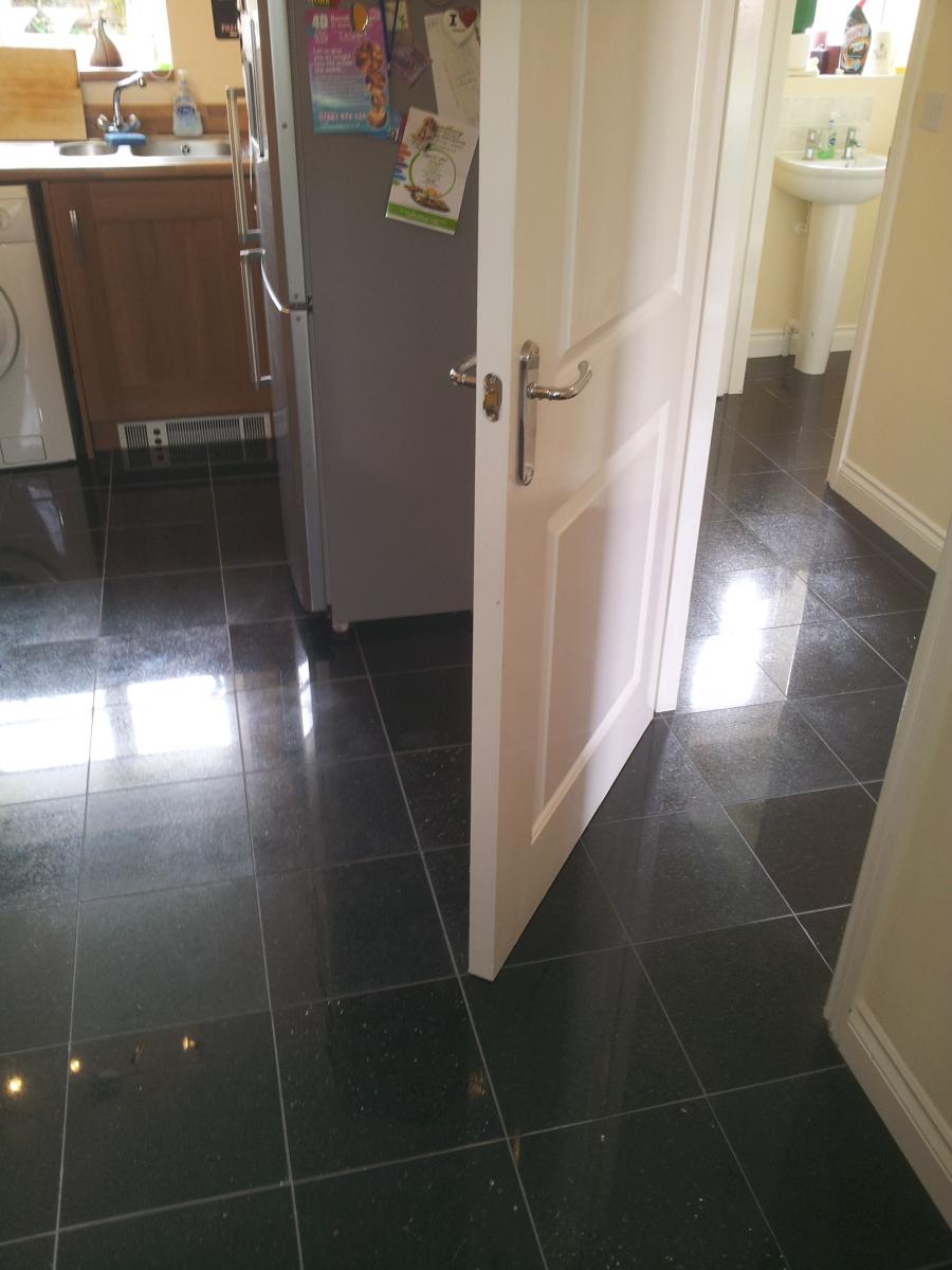

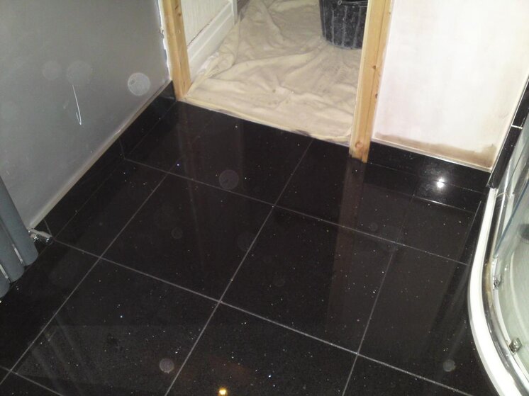

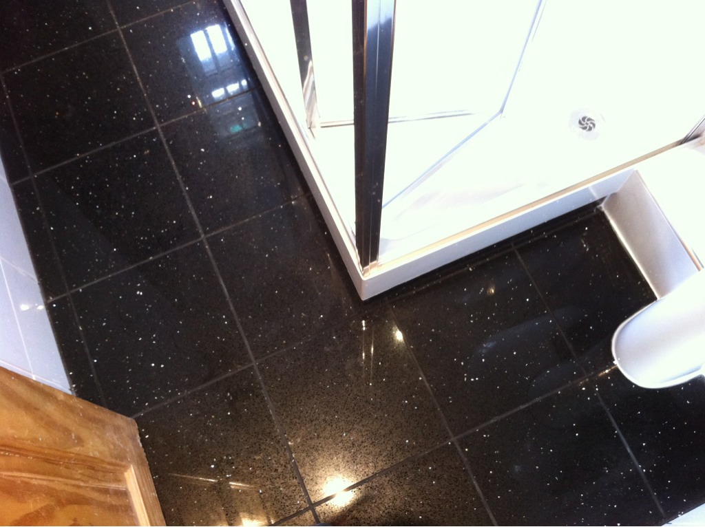

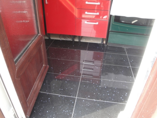

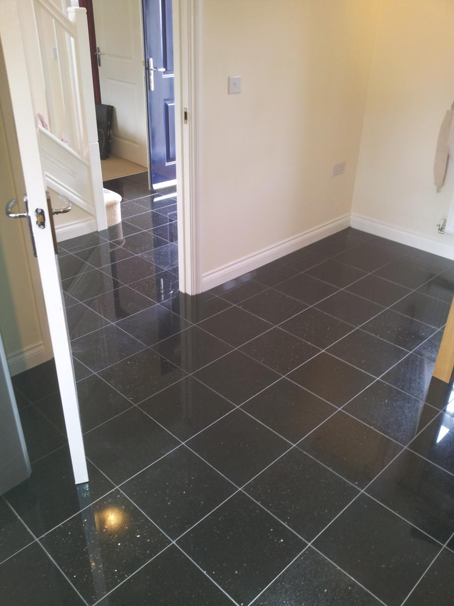

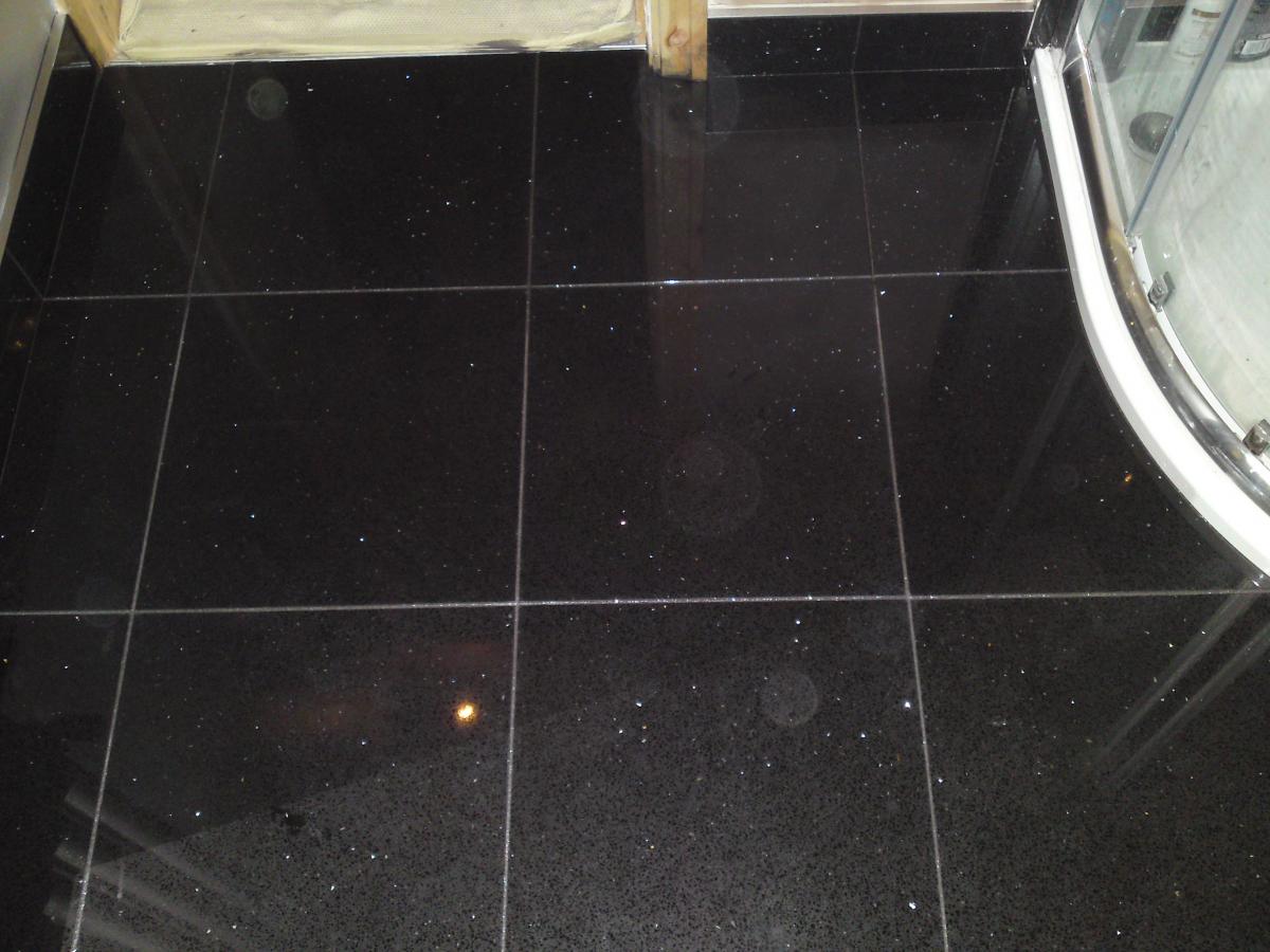

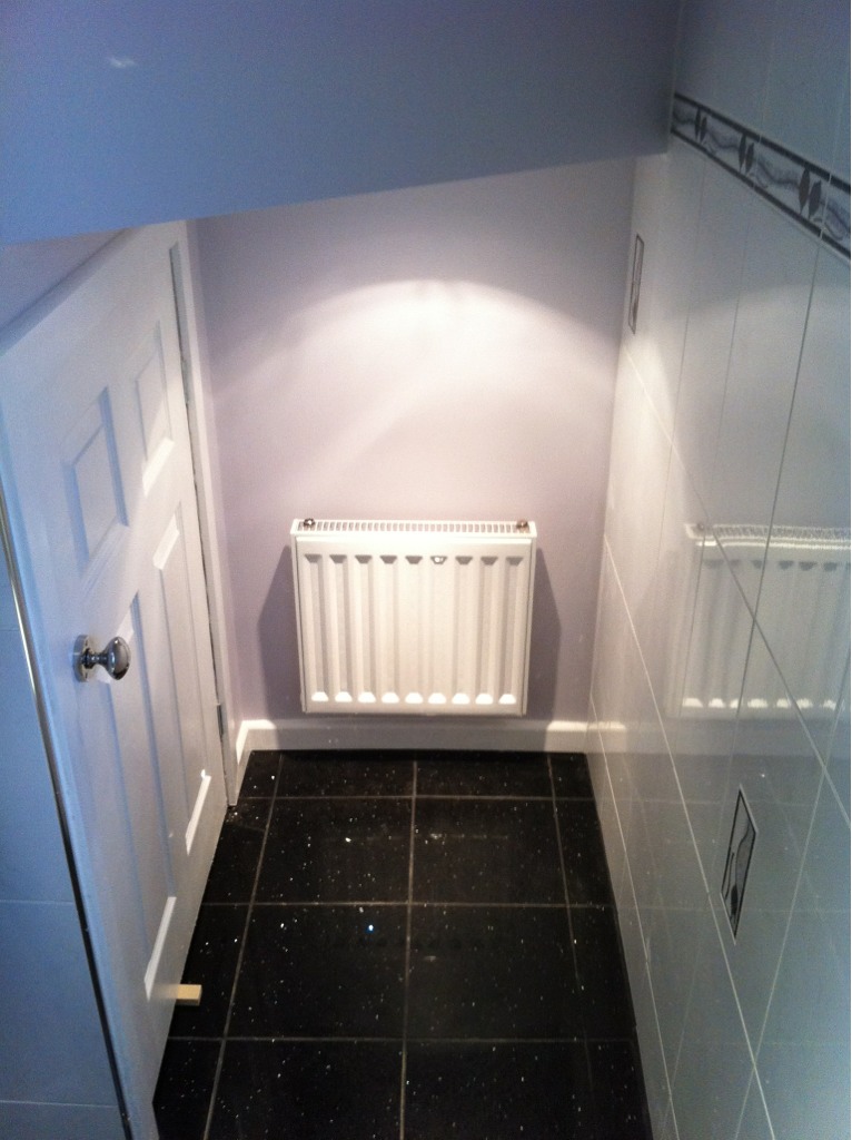

Just had two bathroom floors tiled. I have attached pics but not sure how good they will look on here. Basically the tiles are really sharp like there is not enough grout. He has also done the same to my neighbour, she got him back but hers are still sharp. I've bloody paid him as well. The tiles are wonky and look like no spacers have been used as the strips between tiles are all different sizes. The tiler is coming back tomorrow but I'm not sure what I can ask him to do. Please can somebody help?

Ask him to do it again.
Ask for your money back plus recompense for lifting/relaying and new tiles.
Did you get him to tile after he had done your neighbours?
Sorry but a really bad job that
gamma38
485
1,058
Bedford
I agree with all of the above. Definately ask him for your money back, he will say no I would imagine then go down the route of saying you would like him to re-do the floor. Get yourself a long straight edge if you can get hold of one, lay it flat to show him how the tiles go up and down, then lay it along the grout lines to highlight how out of true they are. It just makes you seem more prepared to him, i'm not saying get nasty, nothing could be farther from the truth. But you need to make him see exactly what a shoddy job he has done.
