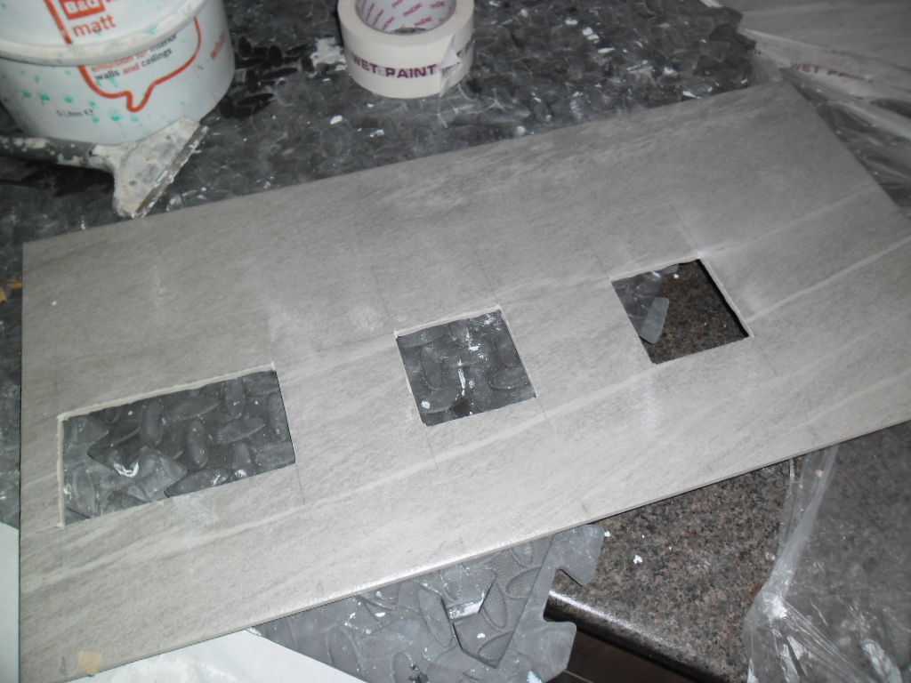

Assuming the electricians have done the job properly, and working on the basis that it's a ring main circuit with 2 wires in the back of the socket, then there's no way you'll get the faceplate through the hole in the tile. Cut the hole in the tile to the size of the backplate, take the socket off the wall, fit the tile, grout, then refit the socket. Job done

If you mark & cut the tile spot on then the socket will fit easily through the cut out on its side.
It's not a problem if your good at your work.

wrong pal, done easy if the wires are long enough. Done it hundreds of times without removing socket face, not a debate on my behalf, just a fact.

I'm no sparks but where is the earth wire which makes 3, the ring main would have wires going in and out....

Have things changed since I escaped UK? A socket outlet part of a ringmain has 6 cables terminated to the back. 2 legs live, 2 legs neutral & 2 legs earth. I could usually pass the plate through a cut hole as long as the cables weren't too short.
