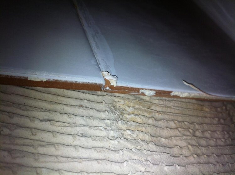

Meanwhile, the reason I'm here: I noticed some tiles were loose on the side wall. I've removed a bunch of loose tiles to expose a damp plastered wall. (see photo1) I'm guessing the wall got wet because the tiles grouting failed between the tiles. I think the reason for this is the lack of any gap between the tiles (crowding) so hardly any grout could be used (see photo4). The good news is that the dehumidifier is doing it's job, should be dry by morning (see photo2).
