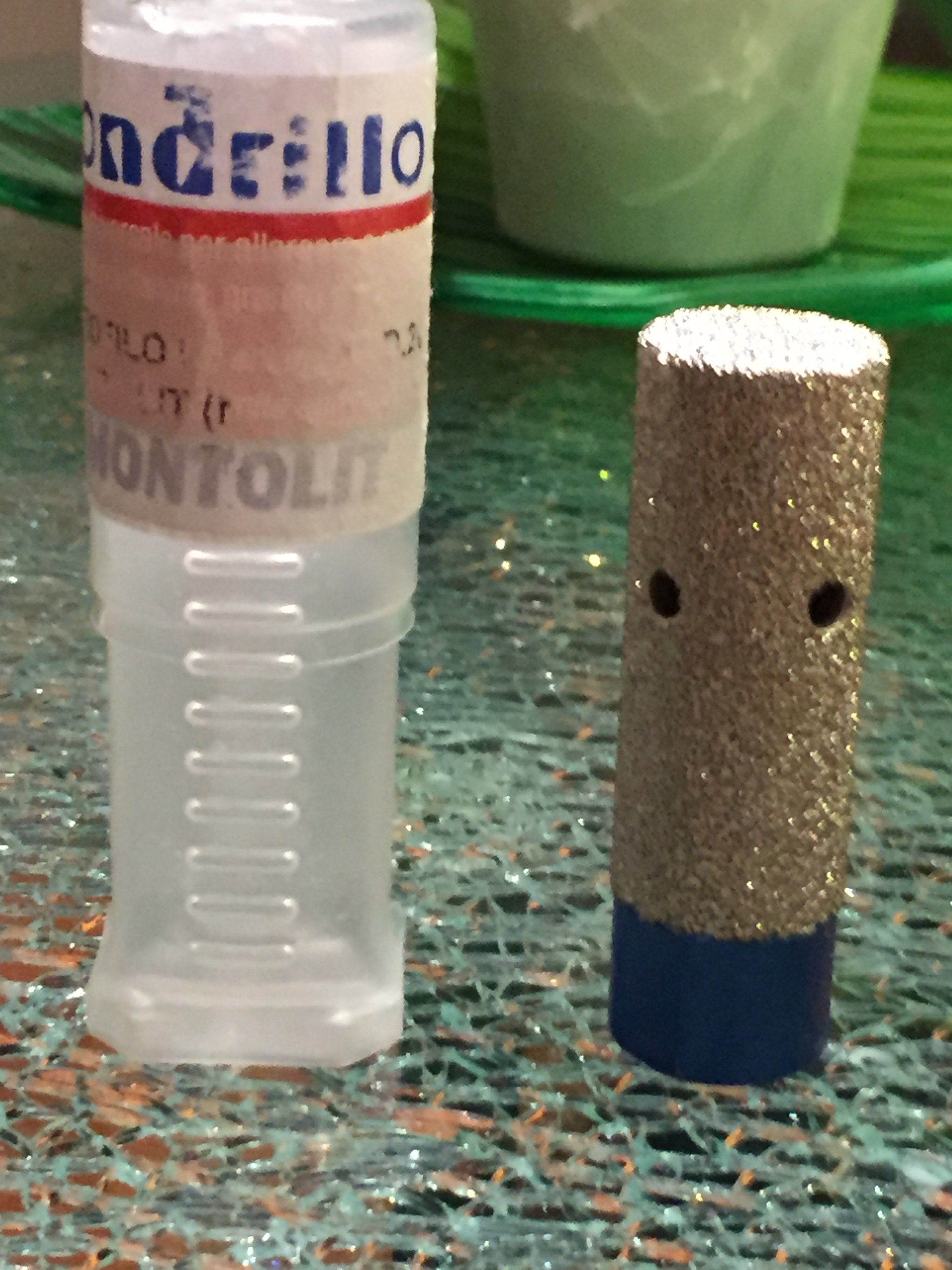

So after a few PM's I think I've got to the bottom of @antonio's intended thread!
Below are two images of new purchases he has made.
The first is drill bit made by Montolit, it is designed to enlarge holes in Porcelain.
So his first question is, here in England how do we enlarge holes in porcelain?
This is a product used by the stone masonry industry in the UK.
They are know as Vacuum Brazed Diamond Finger bits.
In larger diameter they are also know as zero tolerance drums.
Used for squaring up and fine grinding of under mount sink cut outs and similar.

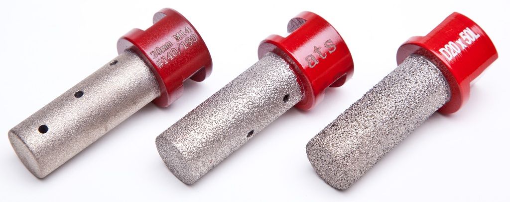

J Sid
I had one from Alan last year, worked very well and would recommend them.
