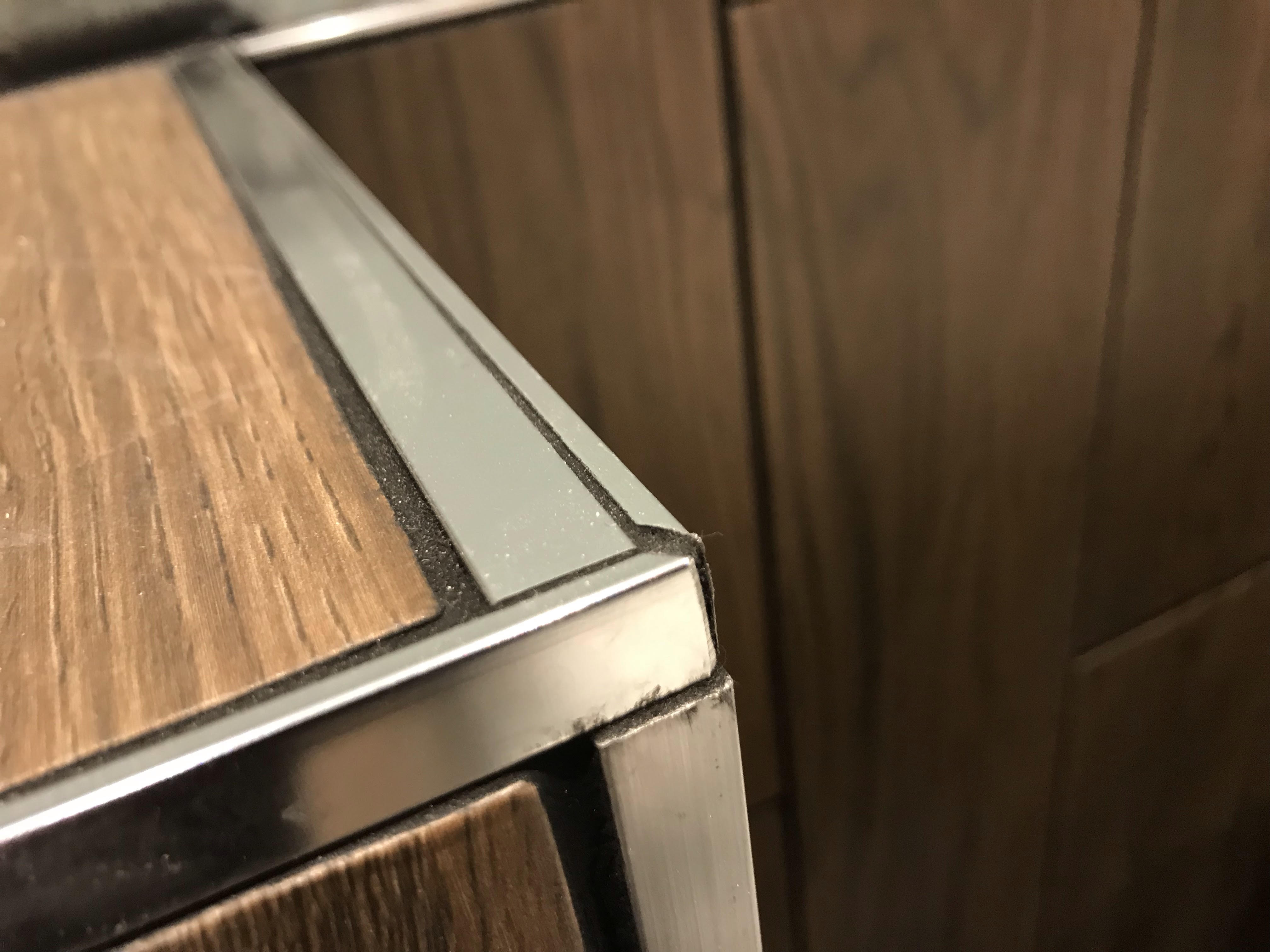

We are currently getting our whole house refurbished. The standard of the work as been very high so far however when it's come to the finish and attention to detail of the tiling in the Main and EnSuite bathroom, well, I think, even having never ever tiled before, after watching a handful of YouTube tutorial videos I could probably do better lol! It just looks like time hasnt been taken to give elements a good finish.
Main Bathroom has been grouted and grout is highlighting the roughly cut tiles. Worried that the same will happen with ensuite.
Is this considered a good job?
Would REALLY appreciate some feedback and opinions from tilers to give me more ammunition to go back to Building Contractor with.

Main 002
Metal edging at corner has razor sharp edges with a small sharp burr too.
