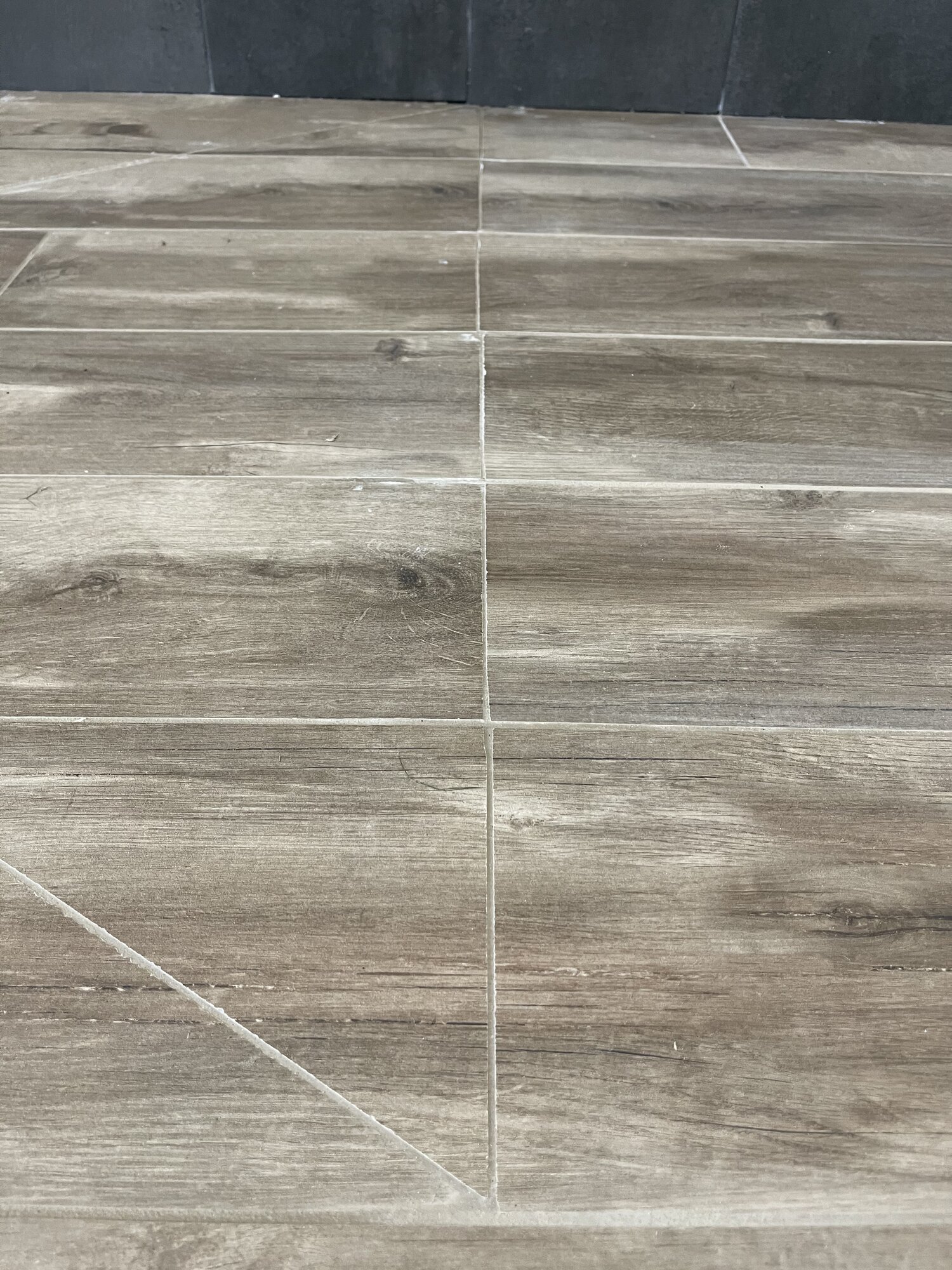

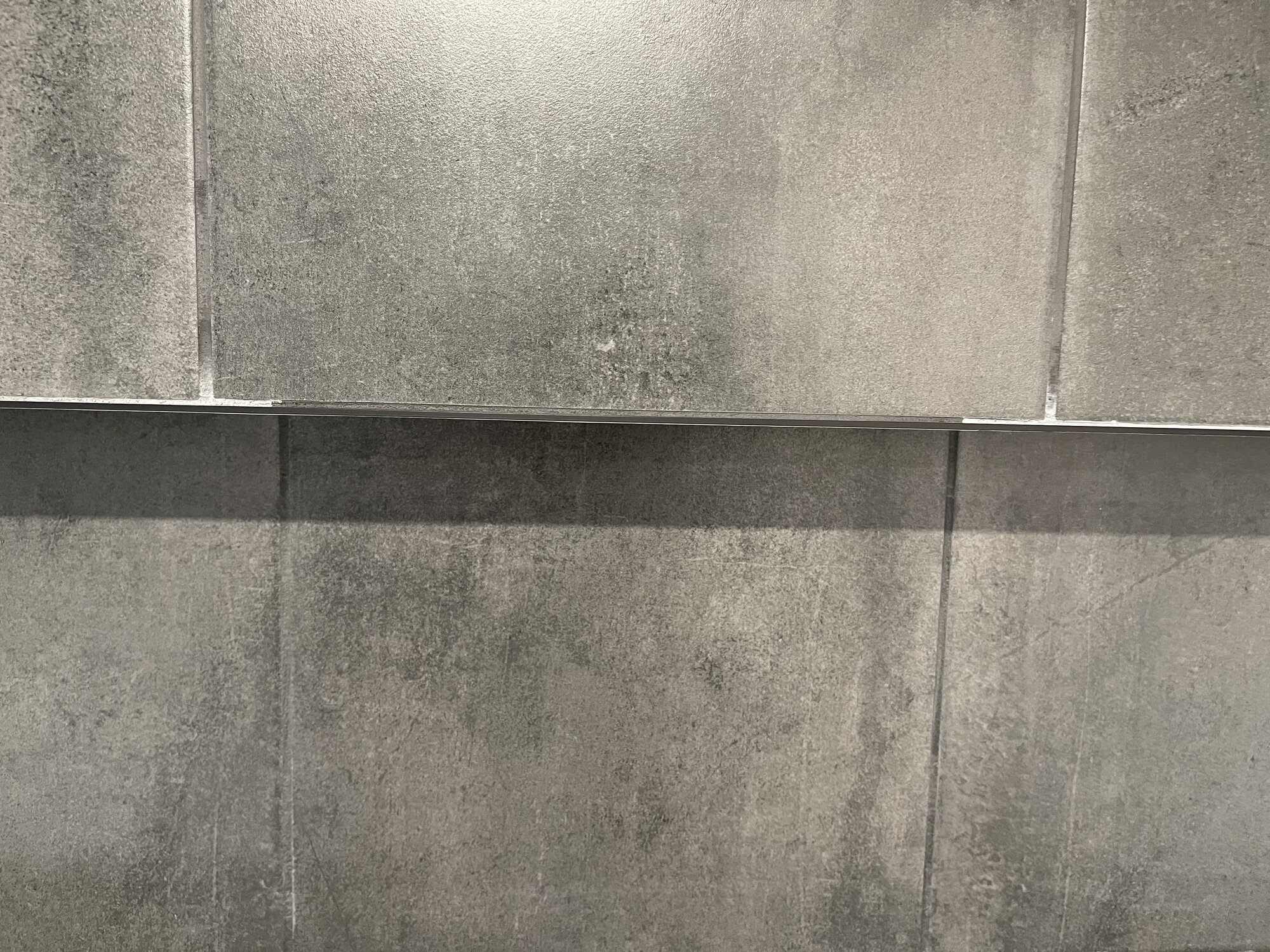

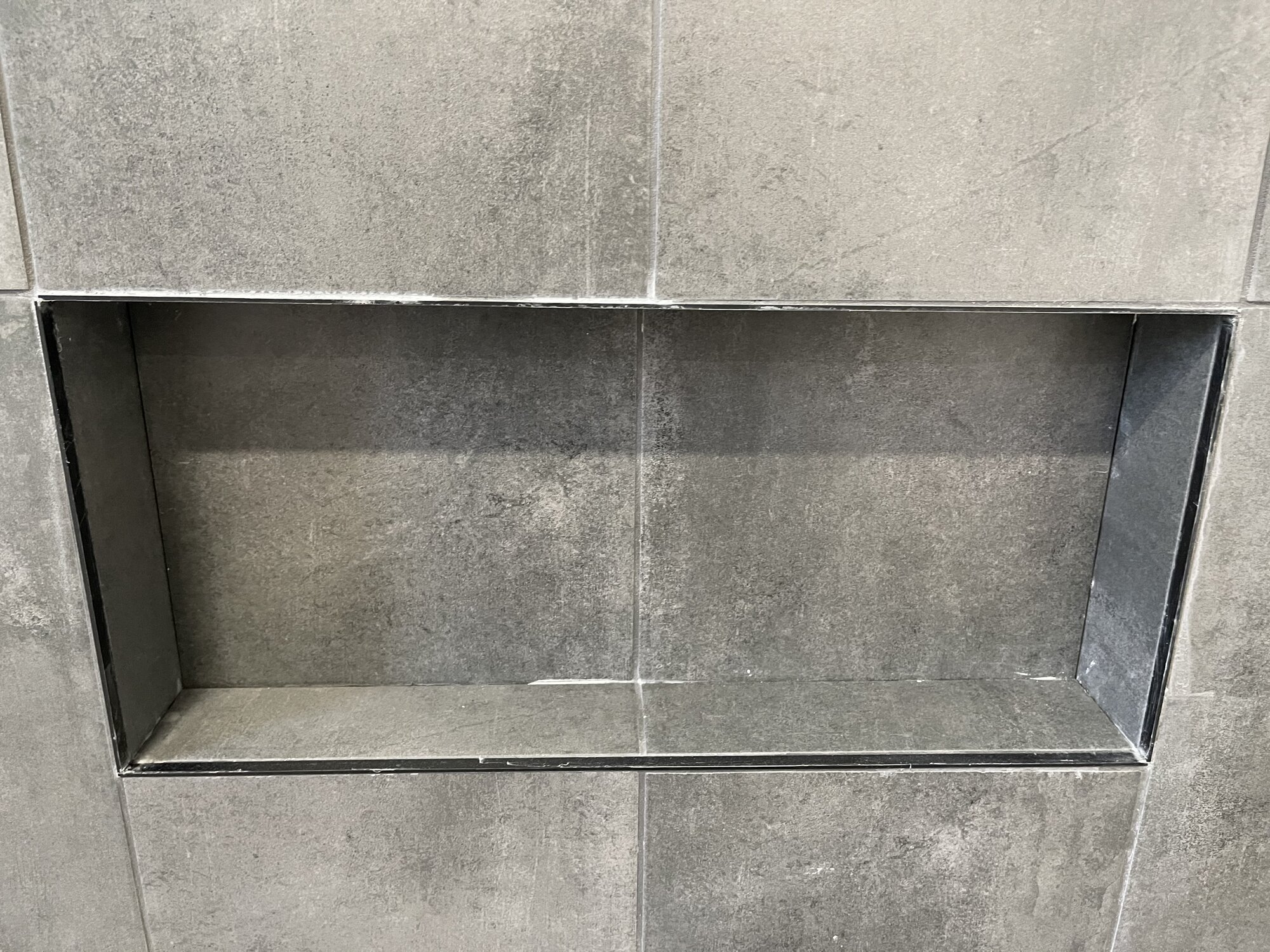

Our builder has just finished grouting our bathroom renovation and we’ve started to notice some issues. Is this us being picky or is it actually a bad job?
We’ve noticed a lot of uneven tiles, some bad grout work and chips in the cuts of tiles.
If it is a bad job is there anyway of fixing it without starting again?

There is issues with slight chipping to edges that should have been addressed prior to fixing by taking the arriss off the edge. The biggest issue/mistake i see is the wetroom tray lay out. You envelope from the four corners of the drain out to the tray edge corners , you do not split them again across the tray as done there. Looks hideous.
on the wall tiling , there is adhesive showing through the grout and the white tiles , the grouting isn’t satisfactory. So yes you have reasonable cause for concern.

1. Adhesive and grout have just been left on the surface of the tiles, it's not been cleaned off properly.
2. Tiles have clearly not been laid level, looks on the floor of your shower that there's a sharp edge of one tile clearly raised higher than the neighbouring tiles.
3. You expect some level of chipping to tiles when you cut them, but that looks prety excessive to me, his blade must be pretty blunt -- and thats before you would soften the edges, which clearly hasn't been done.
4. Loads of poor cuts, too many cut too short or long -- either he was drunk or his tape measure is that rusty and worn out he can't read it properly.
5. Those tiles "shaped to fit" the door frame are a joke; that looks like a 5-10mm gap on your last photo!!!
