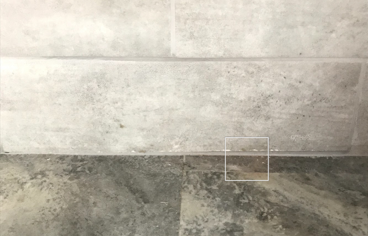

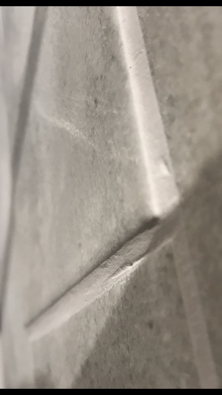

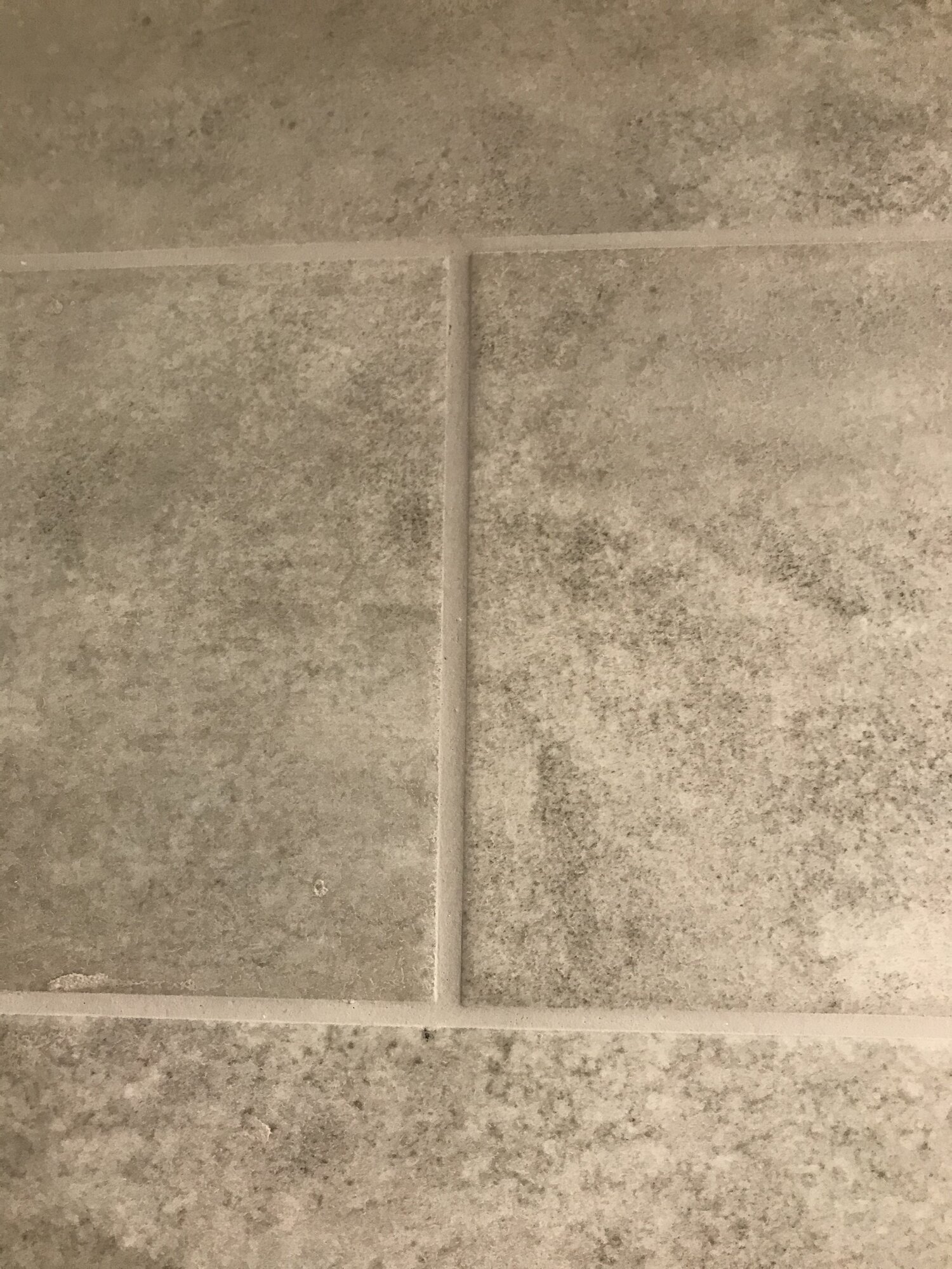

Hi
please let me know your thoughts on this job.
Am I also correct in saying that the wall hasn’t been tanked?
Thanks
Not been tanked..has the wall been primed ? Shouldn't go wrong with 2mm spacers .
Thanks. Sorry I’m not an expert at all. We paid a professional outfit for this job. I wouldn’t even know what priming is but the wall as you see it is what has been tiled on.
All i would say the choice of tiles from the the manufacturer " Johnson Tiles " are some times impossible to make a decent job because of the poor quality of the tiles themselves
"You cannot make a silk purse out a pigs ear "
You can google Johnson tiles reviews and are pretty negative

Hi
Thanks
View attachment 123700 View attachment 123701 View attachment 123702 View attachment 123703 View attachment 123704
Does not look the best !! But a question that made me think also , is why tank walls if you don't tank the floor , and the floor should be tanked into a drain !! What is it with tanking a wall down to a bath level , and then relying on the seal of Silicon to protect the rest of the area !water will always follow gravity ! Unless a whole room is tanked , it is not waterproof !!
Thanks for this advice, good to know.
