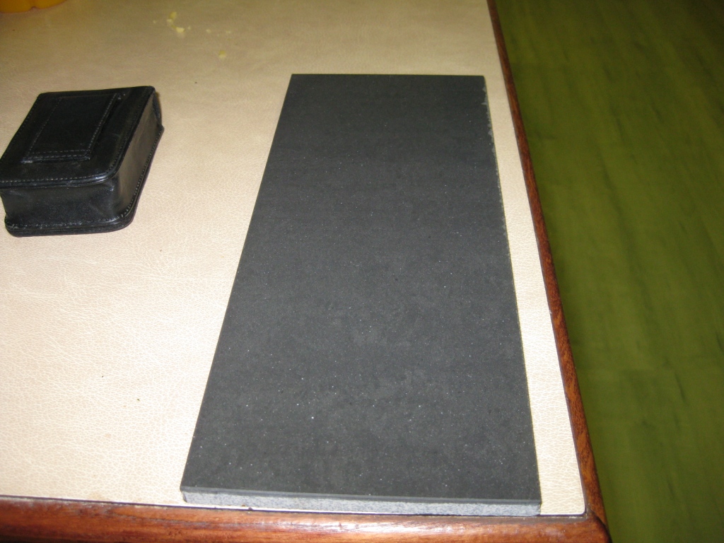

Here are some pictures, although they dont really do the haze justice, as the light reflects of the tiles.
I did look at an off-cut tile that would have been sealed, the haze is there, but not to the degree of the ones laid onto the floor.

when you applied sealer you wiped off the exess sealer and then buffed them it looks as if they have a coat left on them
Yes I wiped off excess and then buffed, they have been washed down again and then polished with a dry cloth, do they need further polishing/buffing ?
Bear in mind that those tiles are not jet back and they have speckles throughout the tile.
The finnished floor doesnt appear to be any different than the tile prior to fitting in my opinion (unless Im going blind lol)
