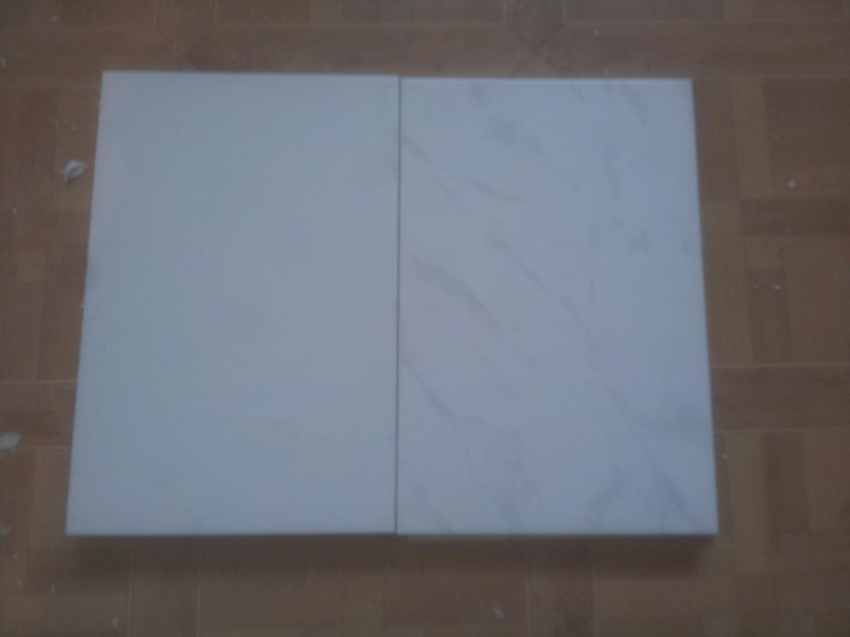

Yet more quality from you know who. 2 boxes of Carrara Marble 250x200 with these jokers inside!
