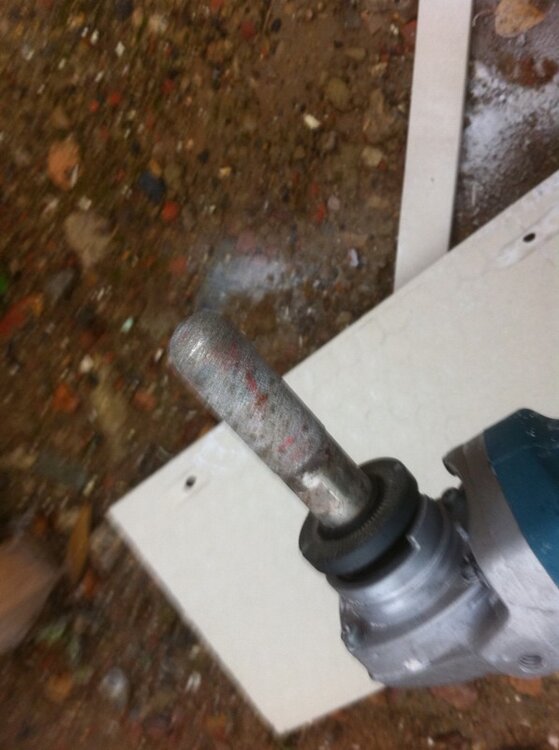

I use a nob type attachment for my grinder when needed as well ( very useful but cant think of what its called)

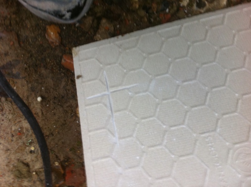

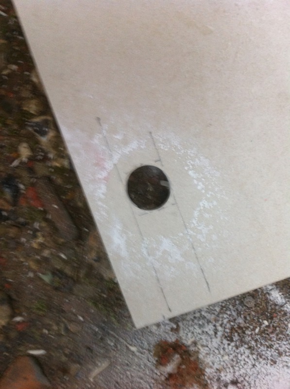

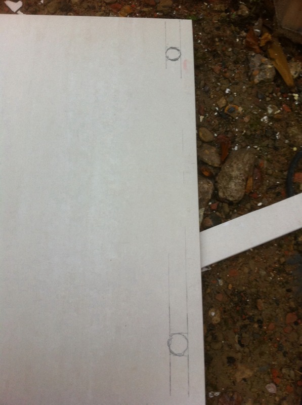

Il post some pics when i next do it , but i basicly mark a circle where the holes going on the tile , carefuly grind the surface,,
Then on the back , grind lines to get the centre of the hole ,, and just grind away till i go through,
Parrot nips finnish it off .... Sorted
Doesnt take as long as it sounds ,
And the holes are perfect so....
When i get some pics you will have a better idea of how i do it ,,

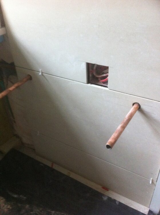

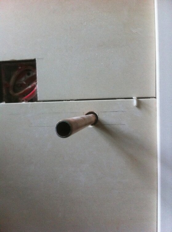

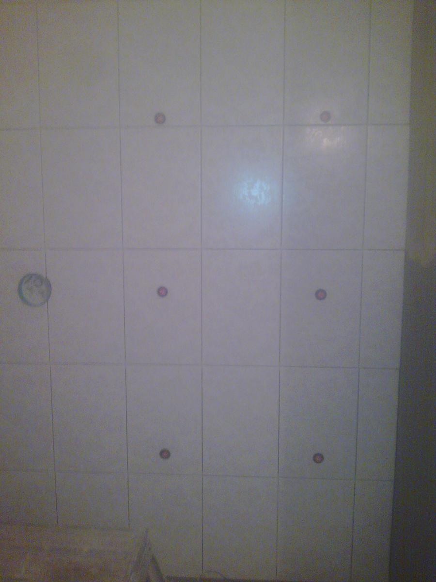

Both holes marked and cut in under 8 minuets ,
Its the way iv always done it and works fine , accuracy just depends on how well i mark it .
I can do small holes , big holes , whatever , no problem .
What do you think??

Looking good as a project. I would certainly agree that its a useful technique and that diamond grinder shown above is a lot different to an angle grinder. Its an diamond core attachment rather than a blade so less likely to do any injury.

You also have to have a lot of skill and patience. Its not easy to grind from the back and get the result to the front.
So congratulations on a skillful use of a tool !
