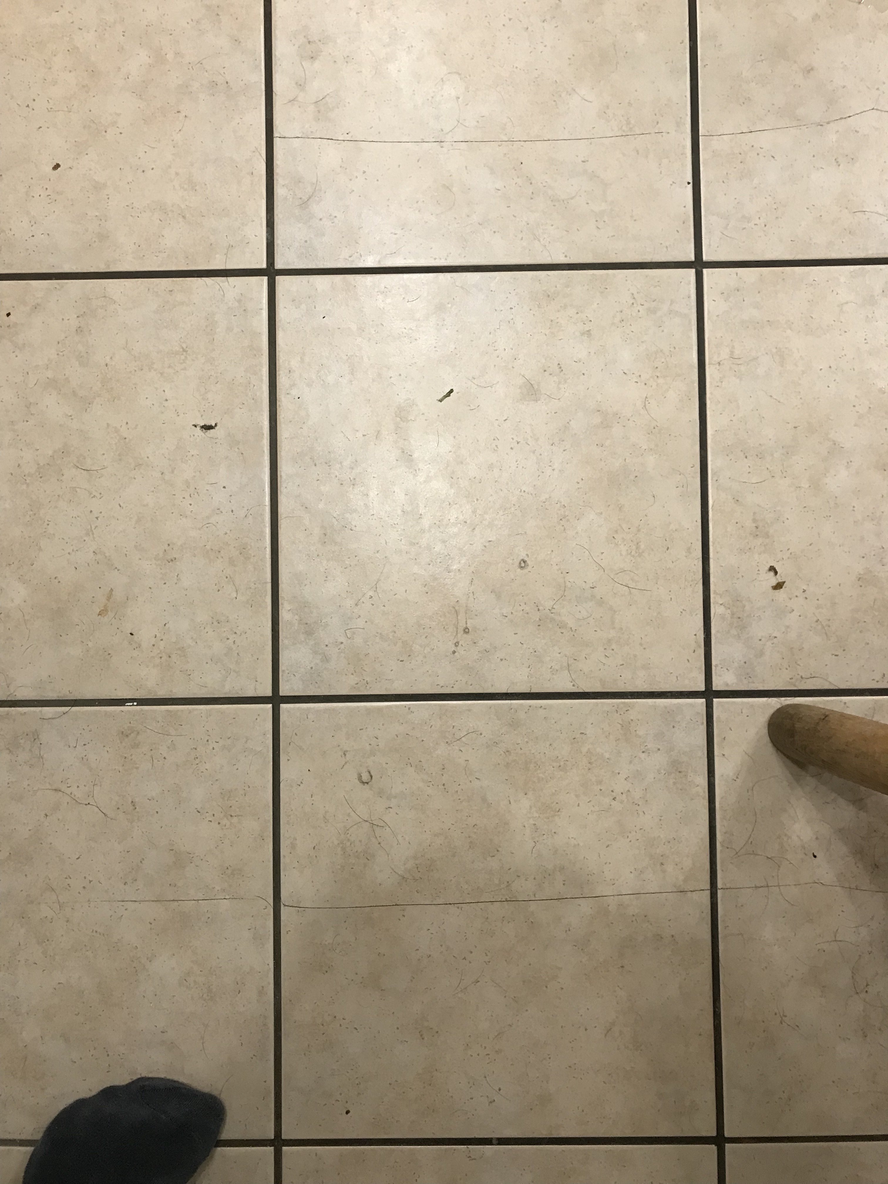

I am going to be tiling my kitchen floor
The kitchen floor has not be touched since we moved in. ( 2019 new build)
The house is an upside down house, kitchen effectively on the first floor
Tiles have been layed down direct onto the floorboards (Chipboard flooring)
Tiles have cracked in straight lines.
Will rip up the tiles and check floor is secure

Might be best to get the floor up and have a look at the state of the chipboard.
Overboarding with Hardiebacker in principal is fine. You would need to make a judgement on the condition of the chipboard. I tend to screw the chipboard down next to the existing ring shank nails before overboarding.
