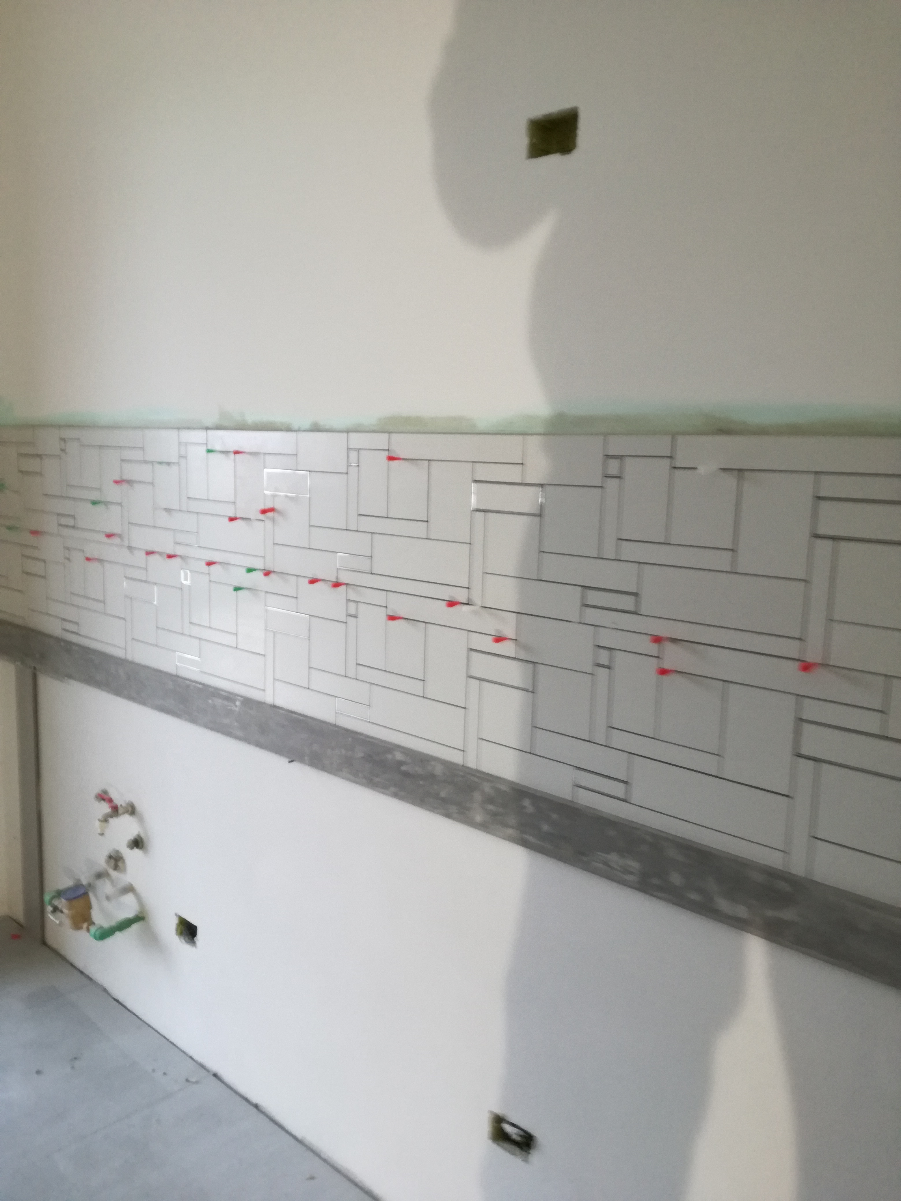

That looks great @antonio!
I really like that, excellent!

Here, all the kitchens are mounted after and leans to tiles.
a 1cm iron binary at the top and one at the bottom is fixed, the kitchen remains detached 1cm from the wall, above and below.
when I start laying the tiles, I have the precise design of the mobile kitchen, this kitchen in particular, took longer than usual, because the furniture leans only 2cm below and 2cm above and all steel parts of the tiles had to be visible.
normally here, they are only 20/30% of the kitchen with tile panels, many are covered with wood, marble or quartz, the same color as the kitchen worktop.
I hope you understand the writing.
