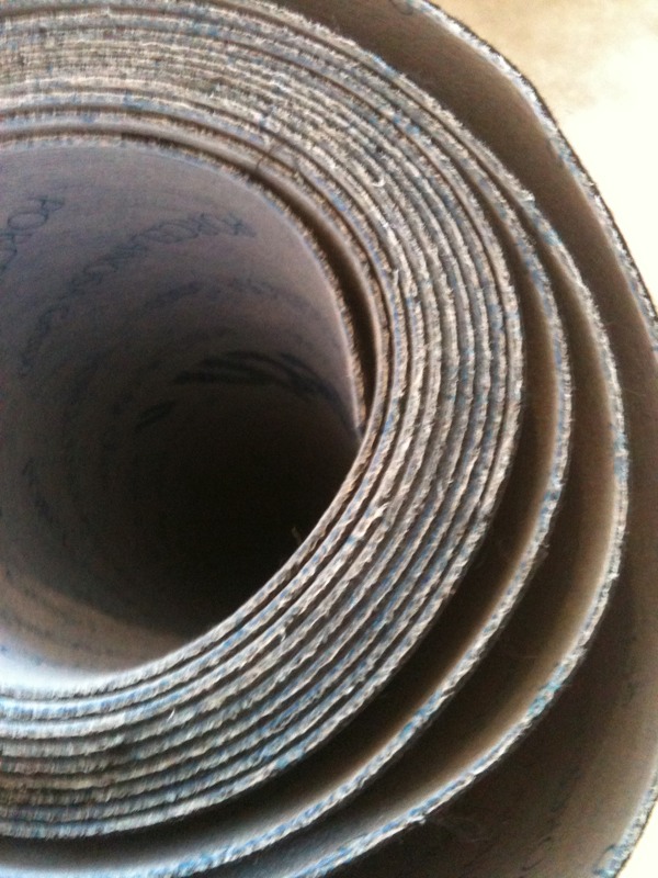

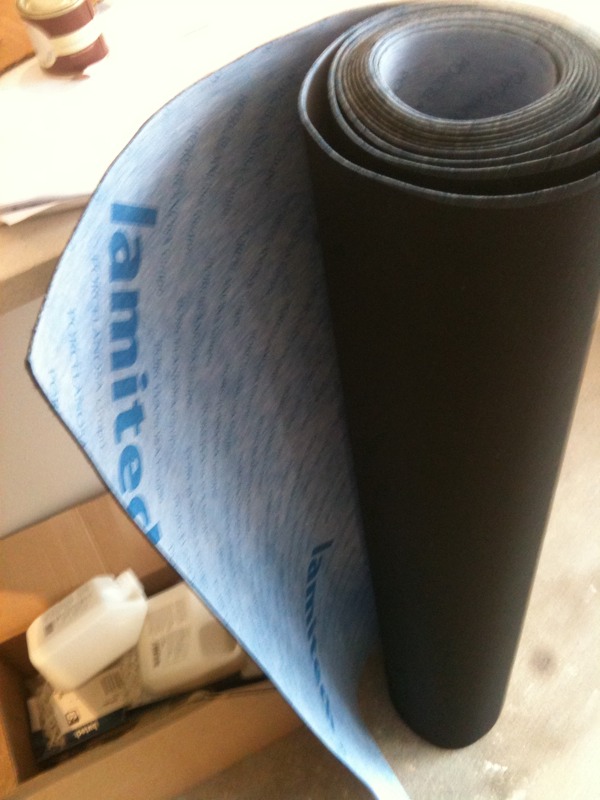

Ian
This is supposed to be a brand new version of this product, looks more like underlay for wood floors! It's got a felt back an a rubber top, what do you folks think?
Sent from iPhone using tapatalk

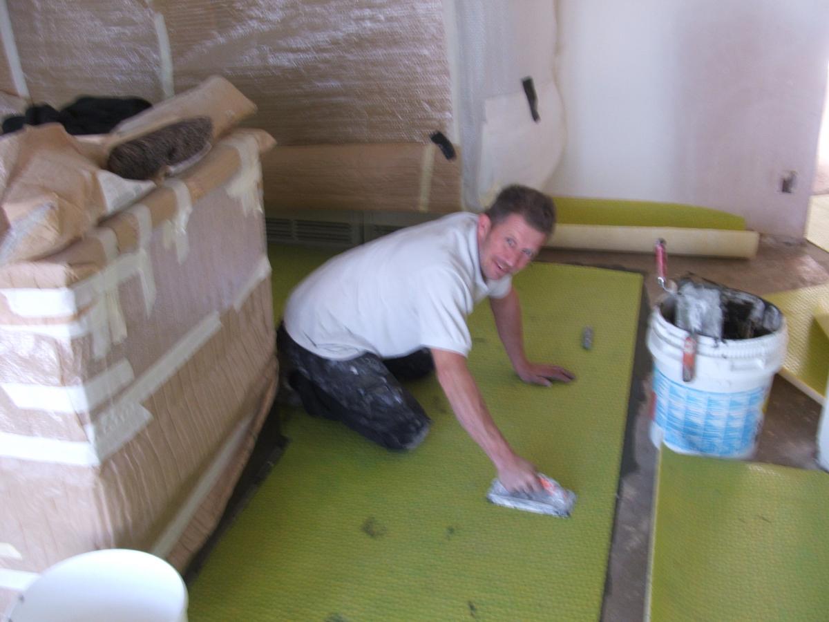

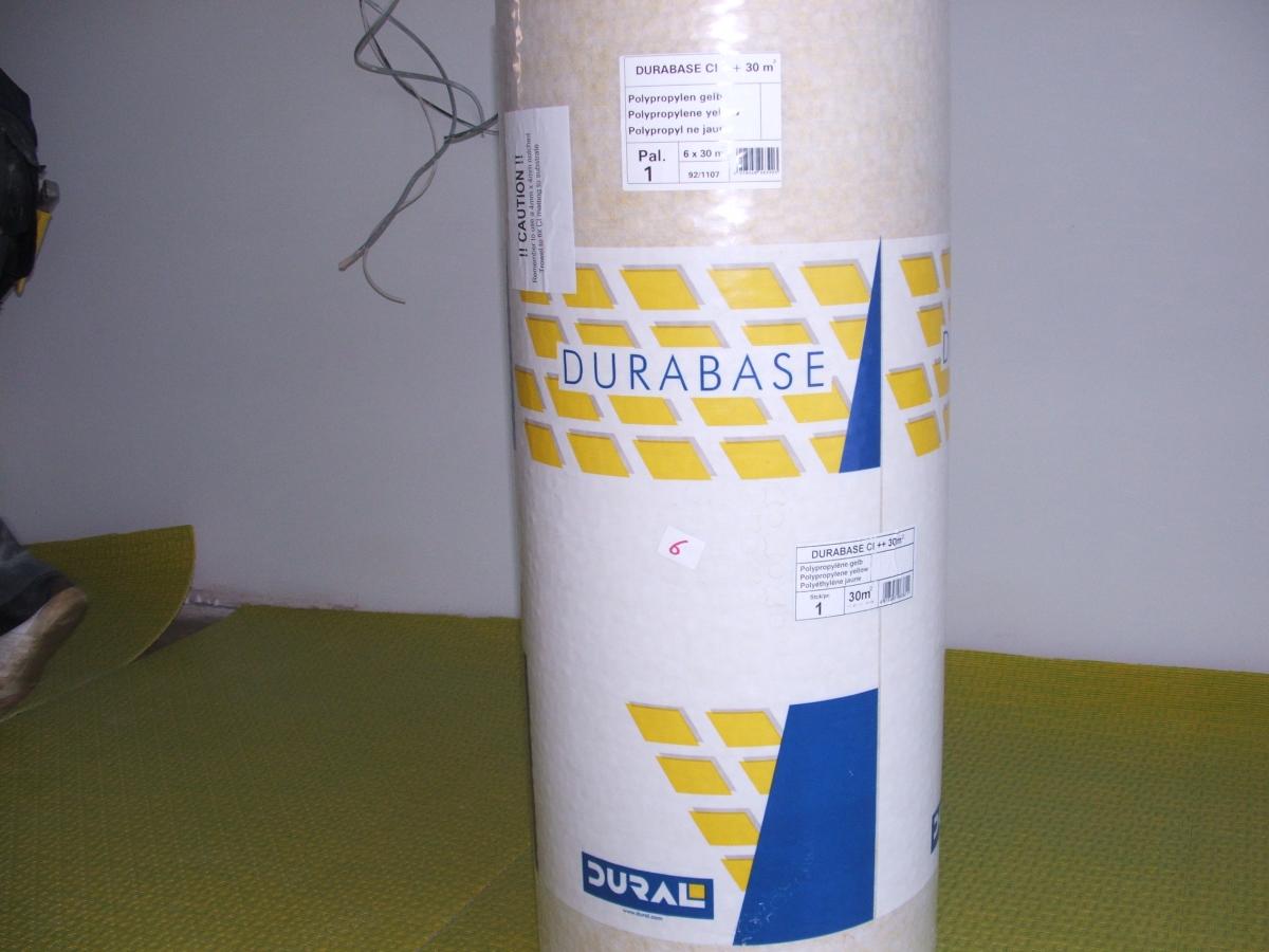

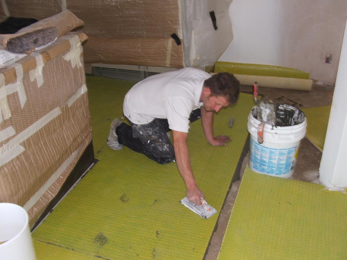

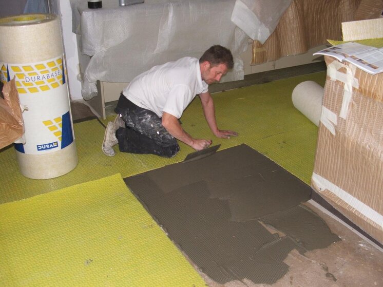

Never heard of it, I buy DURAL .

Yorkshire Tiling Services
Plenty makes out there, Schluter was original, however they will always say their produt best... as time has gone on, there are many competitors out there, most should do the same job.,make sure you follow installation instructions to the letter so as not to invalidate any guarantees. Many faliures result from incorrtect installation and fixing.

Looks a bit like the Homelux Floor that I use quite a lot of, only that look a bit thicker.....
Created on iPhone.....
There are no cups on the topside of this, and as far as I'm aware from reading up on decoupling systems, this is an essential part of the decoupling process. Is the homelux product like this.
