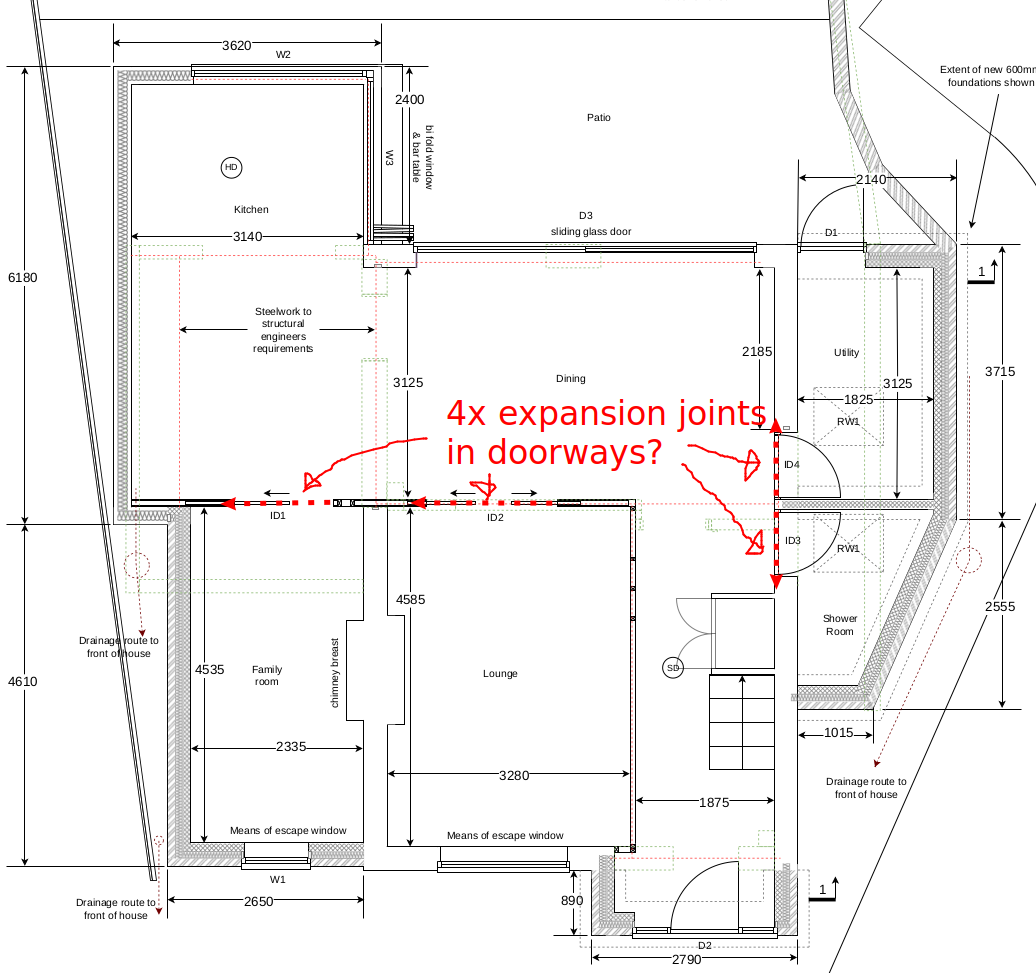

Thanks guys. Would you recommend expansion joints at doorways if we're using decoupling matting already? I'm guessing this would still be best practise, though in practise it "should" be fine without.
And if so, would 3mm Silicon joints do it, or should we be looking at making them 5mm? I've attached an image to be more specific. Thanks!
I always cut in the doorways even with the matting, as it’s usually the weakest part of the floor and it’s not
Always possible to get a tile around a door way (depending how it falls at the door way) especially a 1.2x1.2. 3mm joint is plenty. I would use matting with that size. The bigger the tile,the weaker they are!
