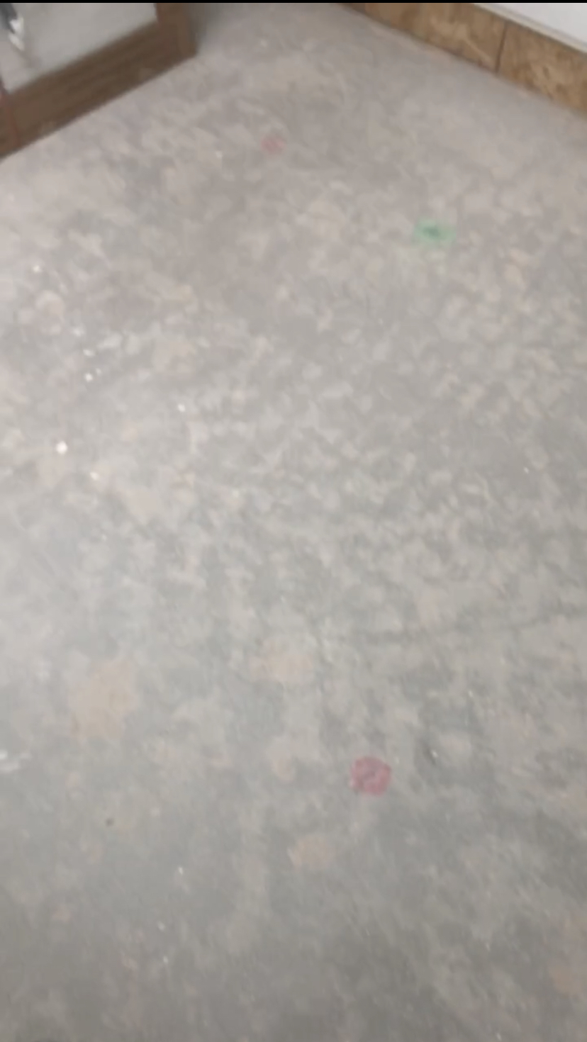

Cemfloor being a liquid screed will more than likely have layer of laitence on top, this must be removed.
This can normally done with a floor scrubber with a 60# copper disc.
It presents as a scum on top of the screed, although a lot of screed companies now claim that their liquid screeds are either low or no laitence finish.
It’s a very dusty job without correct dust extraction equipment, ensure area is well ventilated and masks are worn.
Although most hired sanding equipment is supplied with dust extraction equipment, check before hand.
Vacuum and prime post sanding.
This is a cemfloor, two images, one before and after sanding.

Cemfloor as with ALL screeds should be subjected to mechanical preparation in order to remove surface contamination, laitance, mud, plaster etc etc. In the case of cemfloor particularly it has a spray in curing agent applied on installatio this helps prevent plastic shrinkage cracking. It is not physically a part of the screed and should be removed. If this has been done already that's great but if not then light sanding is wholly appropriate.
