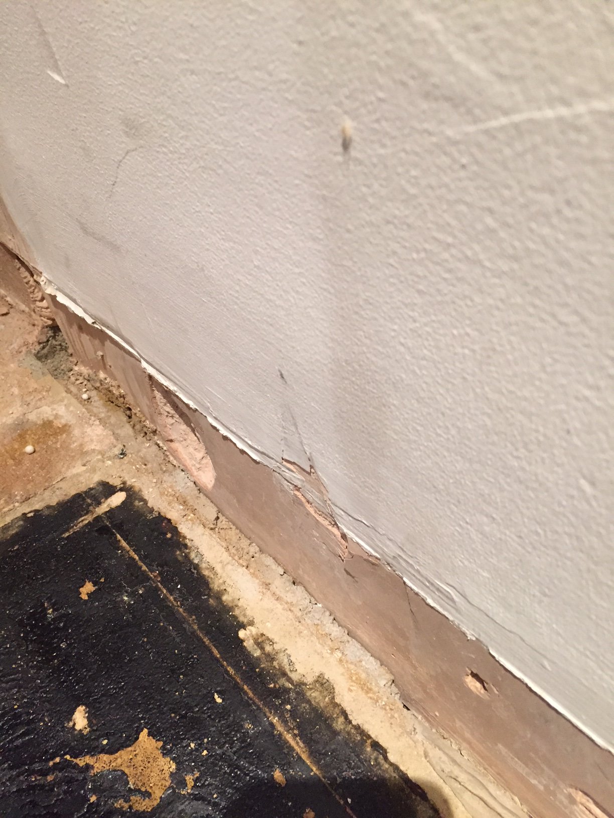

I have ripped/stripped out an old bathroom suite (inc stud wall splitting cupboard & shower enclosure). It's at the point where the walls need re-plastering (where old tiles have been removed) and the old flooring has been taken up.

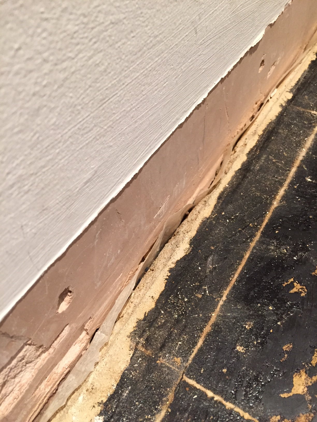

The old flooring was vinyl sheet (on top) but was laid over old 70's style Marley Tiles (which I have now removed as well). This has revealed some black, Bitumen which appears to have been used as an adhesive for the old tiles. Once I removed the old skirting, there was also signs of a plastic membrane (only on the wall which joins the downstairs bathroom to the garage next door, not on the other 3 sides). Please see pic attached.
I would like to install 2msq of electric underfloor heating (once subfloor sorted) and then, finally have new Vinyl floor laid over the top.
My main question is, after priming the existing surface with something like an SBR Primer for adhesion ( & given the above):
1. Would I be better using a levelling compound to achieve a nice smooth, flat surface? Would it be an issue if the compound touches the plaster at the bottom of the walls...? Will this drawn moisture up? Will this be ok laid over the Bitumen?
OR
2. Use something like No More Ply instead and trim to fit. If so, any suggestions on best adhesive to fix this to the existing concrete floor? Can I lay underfloor heating underlay directly into this (after priming)?

Remove as much of the bitumen as you can and then prime with a slurry coat or with either Mapei or Tilemaster's prime and grip. They're suitable for priming bitumen.
Then stick down insulation boards with tile adhesive.
Stagger the joints then tape the joints with a wide scrim tape and smooth tile adhesive over the tape.
That way you'll heat the room and not the screed. 🙂
Exactly as @3_fall said, however as you're using a vinyl make sure you have enough height for a 10mm self levelling compound over the top of the cables.
