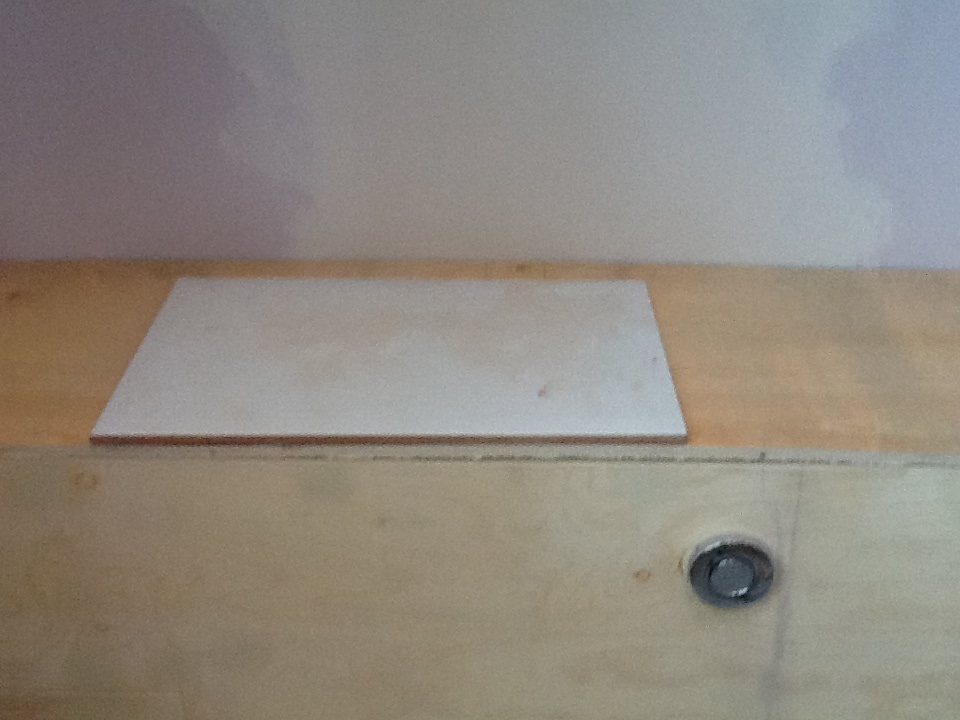

Hi, I live in London and am just having my bathroom finished. I have decided to use up my spare tiles by placing them on the surface of the loo on top of the plywood. (It's back-to-wall with a hidden cistern.) We want the tile edge AND the plywood edge covered neatly, and my builder says that a T shaped plastic white trim exists. (He bought some ages ago, but can't remember where!). I have been to the tile shop and they can't help. Maybe it isn't something specifically for tiles, maybe for something like furniture. To cover the tile edge and plywood edge it would need to be about 12mm Does anyone know where I can get this - and what it is called? Advice appreciated.

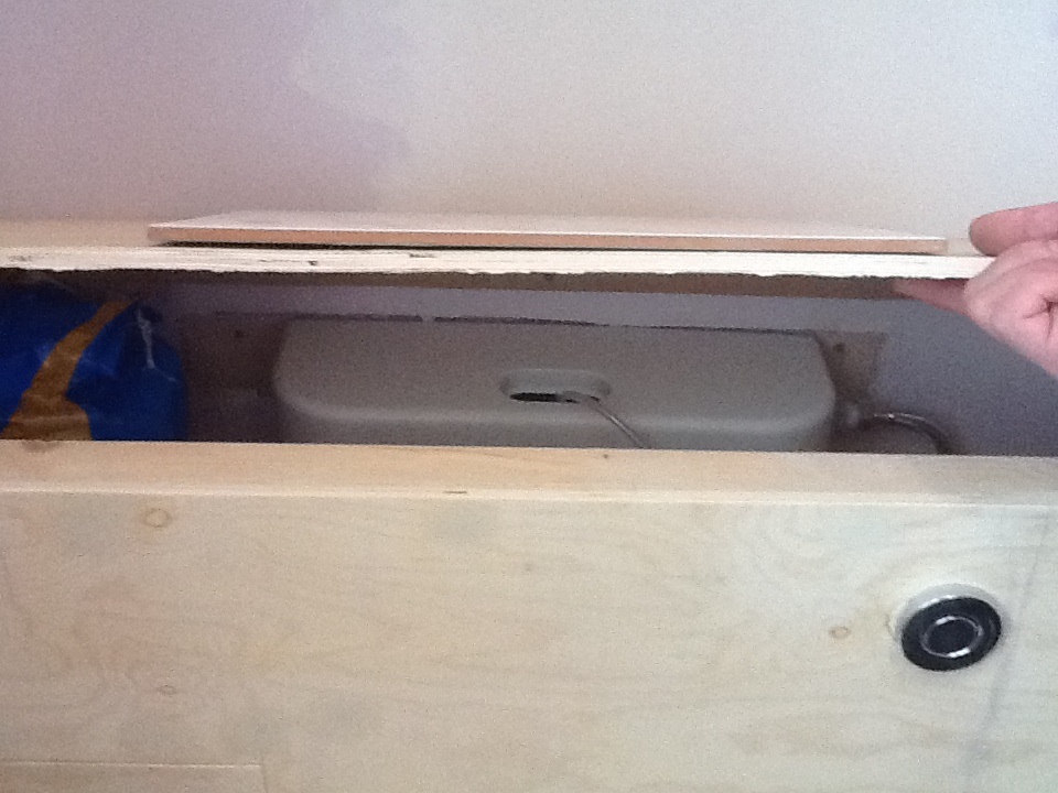

Hi, thanks for replying. My tiler hasn't yet done the work. The reason we do not want to use an L shaped trim is that we want a smooth finish underneath ie the plywood surface will cover the cistern, and will only rest on it (so that I can lift it to get access to the cistern). A T-shaped trim would go under the tile, covering the tile edge and ALSO covering the plywood edge below. (The T-shape would need to be 12mm above and 12 mm below). I hope this is a bit clearer! (I have tried to send pictures but I'm not sure if I have attached them successfully!)

As Dave said, that ply is way to thin as it will warp & twist. It'll need to be at least 18mm as this is not secured. I would either secure the ply down, treating the underside with an SBR & fit an access hatch into the top such as this:
If you would rather keep it as a full panel access, change the ply for Hardibacker 500.
