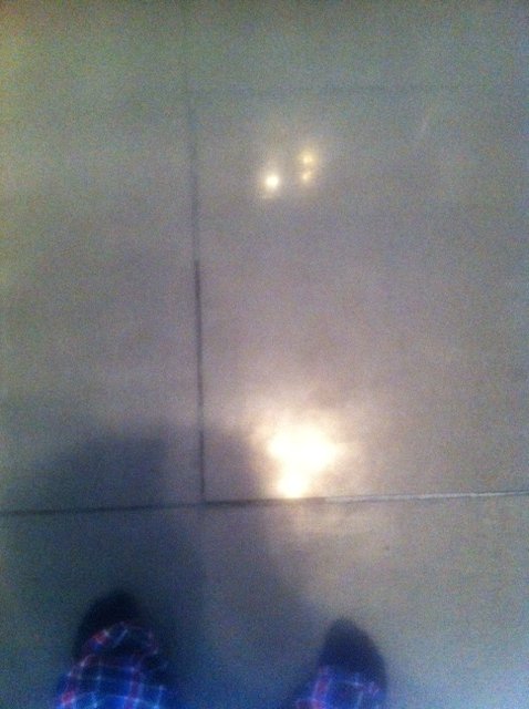

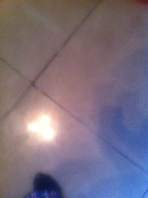

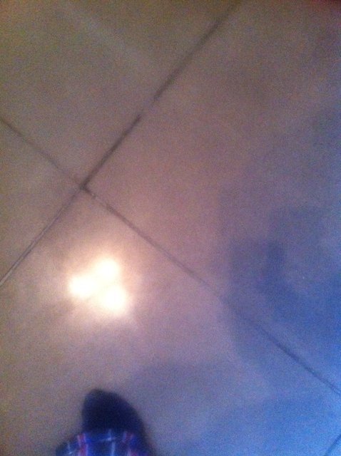

Can u upload some picture please?
If u want to stand any chance of putting it half right before u know who comes home, we'll need evidence to bury u later, sorry I mean help u out! :rolleyes:
Some of the area as a whole, some closer up of the floor beneath to see if we can determine what it actually is.
And it's useful to show the damaged areas along side what's still stuck down.

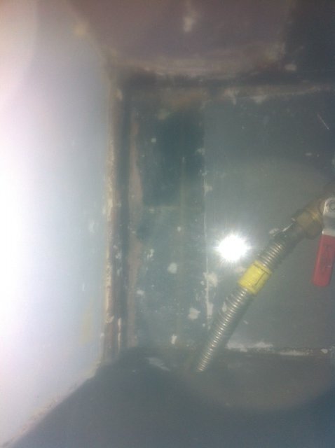

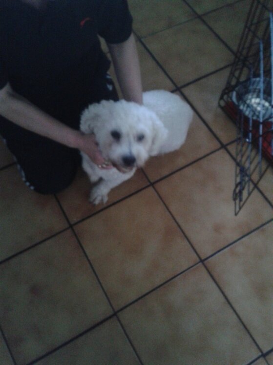

OK here goes the one with the pipe is the hallway floor
[/IMG] The one with the dog is the tiles before.
