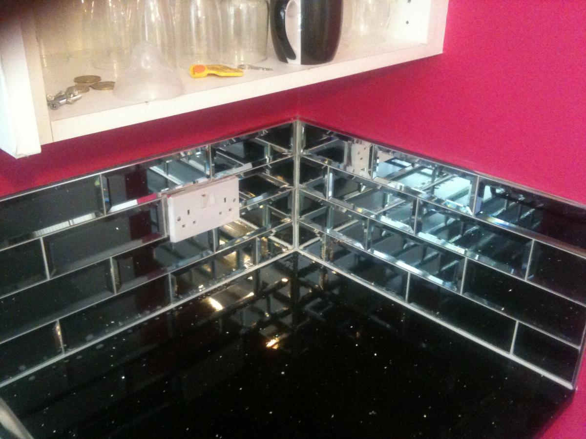

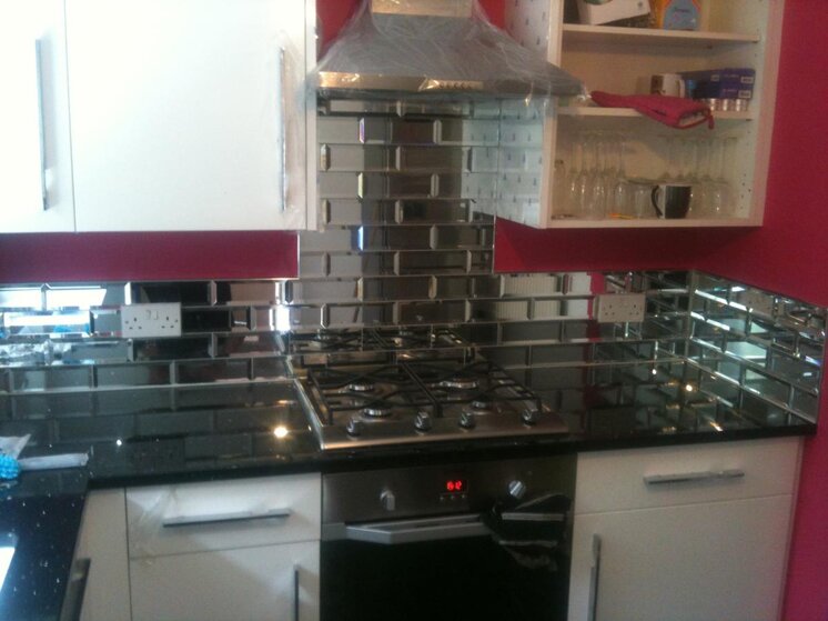

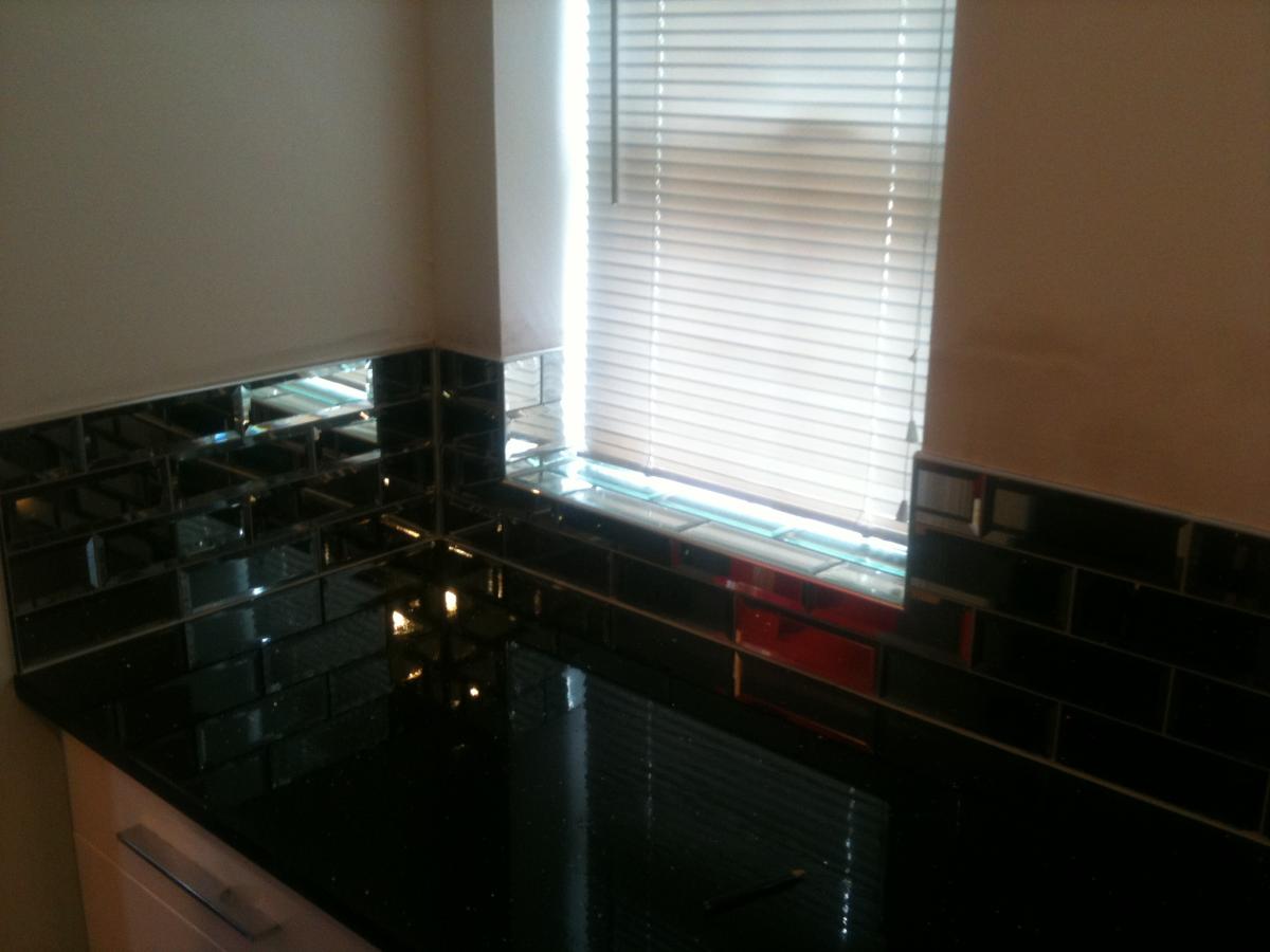

cheers all this is how it looked in the end
cheers all this it how it looked in the end
yeah im over the moon and so are they , yeah they are going to change the sockets next week .
:8:Hi it looks lovely, i was wanting to use mirrors mosiac tiles that give a pixilated lookbut i like yours too. where did you get your mirror brick tiles from and how much if you dont mind me asking. I have the same worktops with white gloss units
Looks good......very bling!
Great to hear back from old posts and see the end results thanks for sharing.
