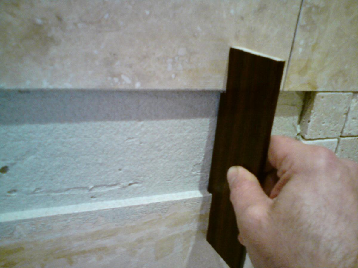

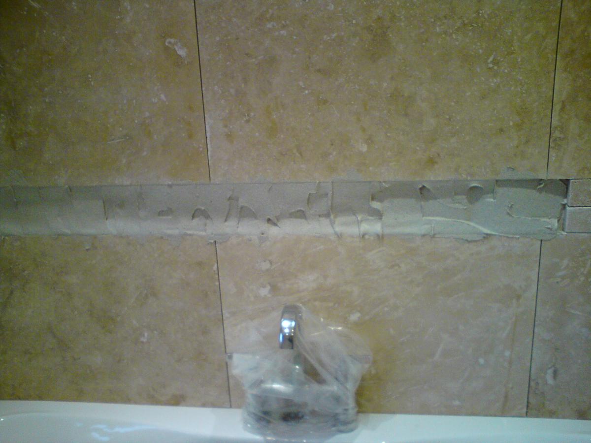

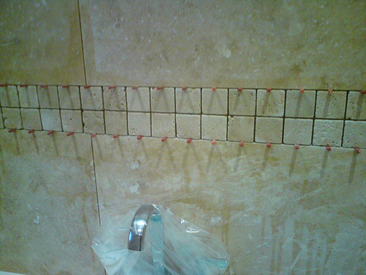

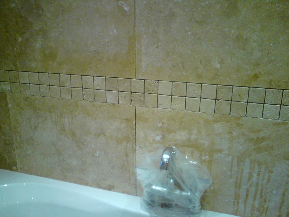

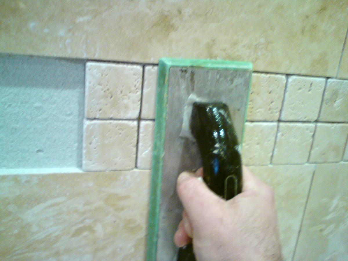

the question of fixing mosiac strips as a border whem they are thinner than the tiles comes up on here now and again.
I was laying in some mosiac borders today and took pics to illustrate one technique you can use.
the addy is benfer standard set c2
Spanish

how do you leave the required gap for the border spanish ? i usually go to wickes and buy some plained timber pack (around 8 quid for 8 lengths) get the nearest size to the border size then stick in where border goes then put the top half on let it set take out the timber then put the mosaics in exactly the same way as you works for me !
