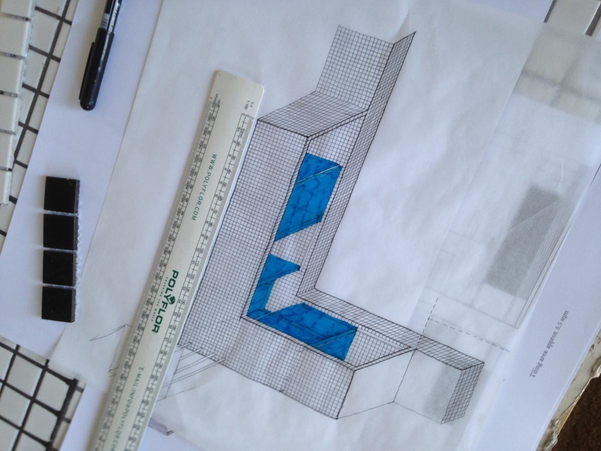

Hello stars of the tiling world, hope everyone is well, been a while since i posted on here, need a bit of advice, hope someone can help, customer wants to tile kitchen units in mosaic (see pic attached) she wants to construct the unit out of ply, i have suggested sticking 4mm Marmox on top of this prior to tiling, how would you go about this?
Also she is having UFH and using the following method:
- We'll ensure the existing floor is absolutely level first (use self-levelling compound)
- Thin foil insulation
- Polypipe Overlay 18mm screed panel with pipes
- De-coupling layer - Dural DURABASE CI++ matting
- mosaic tiling on top
Anybody see any flaws? Do you think this method would be ok with thin white ceramic mosaic?
