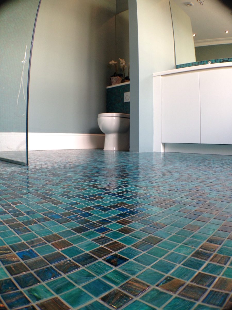

You'll never get a satisfactory finish over UFH with adhesive unless you're very well practised.
Personally I'd overboard with insulation boards, glued (tile adhesive) and screwed with wedi washers.
Then install the UFH and latex over the top to give a satisfactory surface for tiling, then tank over the slc before tiling with mosaic. That way you'll have a watertight installation and your UFH protected.
The same as this.

Great looking floor by the way :handok::sunglasses:
