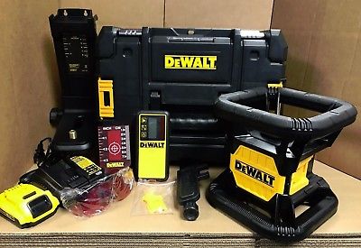

Found this one on evay. Says its new but missing the glasses.pic shows it has the target. Do they all come with remote john
