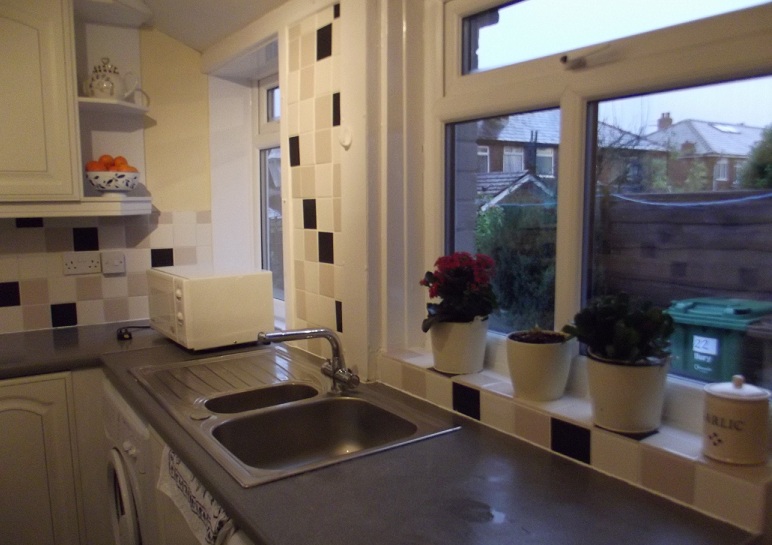

All finished. Here are the pics. Hope they come out alright.
