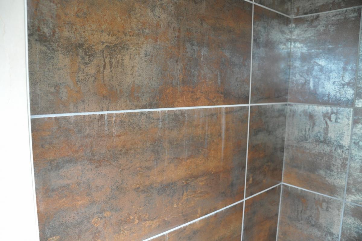

We've just had a new bathroom installed. On the tiles in the shower area, we opted for grey grout. The shower has been up and running for 3 days now and I have noticed streaks coming from the grout running down the tiles. What is this and how can it be eliminated?

Sounds to me like it's just a dusty residue that's been missed in the grout joint.
Give it 24-48 hours to completely dry out, get a soft 1" to 1 1/2" paintbrush and dust it out. Clean over with a residue remover and then apply a grout sealer to the grout joints.
I'm presuming by the size of the tiles that they are porcelain so the following products are fine to use:

It looks like streaks from washboy residue! Did you nottice when the tiler done the grouting. Did they allow the tiles to dry then dust off?
Charlie1 has a point here actually. I don't think it's left on the tile. It looks at least from the photo and your comments on your tiler that he/she has done a good job.
We've had a thread on here somewhere before (i think) that i've commented on. It was about washboy sponges. I've mentioned in that post about new sponges holding too much water. If the sponge used in your case was leaving behind too much water you will get a dusty residue over your grout lines once dry. If your tiler has missed these when dusting down i'd expect to see what's gone on in your photos.
You can try the products i suggested but if you wanted to save a few pennies then just use a damp cloth to wash the walls down. Rinse out regularly and ensure it's not wet just damp. I'd still use the sealer once clean and dry though.
I personally would get both though. It's the product made for the job ;)
Good luck, hope i'm right now!
