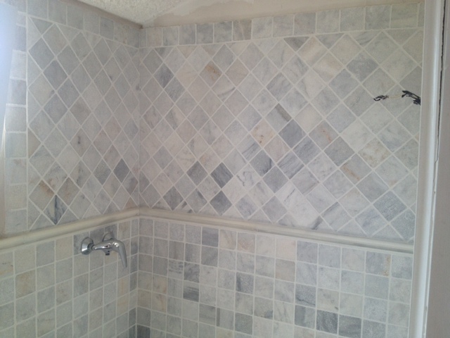

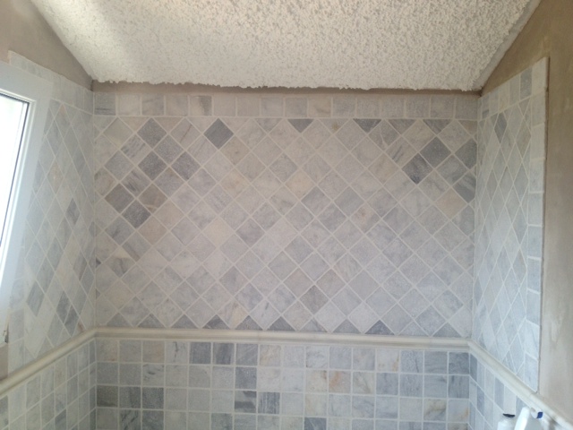

Hi guys,
My builder is just about finishing a retile of my two bathrooms. He's laid 24 square metres of 10cm x 10cm tumbled marble with 17 square metres of bull nose dado. He's done a great job.
However he's now asking an extra £xx because I asked him to tile in a diamond pattern above the dado rail.
For both bathrooms this adds up to an area of 4.39 metres square in a diamond pattern but he claims that to create this diamond pattern has taken an extra weeks work.
This seems ridiculous and calculates to £xx per square metre extra ontop of the money I've already paid to have them tiled anyway. It'd be over £xx square metre if I combined the quote cost and extra cost.
In real terms 62 tiles have been cut in half to form the edges and the rest just rotated 45 degrees. Is that worth £xx extra? Is there much more time involved? An extra week?
When I specified the diamond pattern nothing was mentioned about an increase in cost or difficulty and had I know it was going to be such an increase I would have just kept the tiles horizontal.
Putting aside that I didn't authorise the increased cost, I've built a good relationship with him (so I thought) and would like to use him again on other projects in the future. I don't wish to fall out but is he justified to ask for more or is he just trying it on?
Thanks. Appreciate your comments.
Bathroom 1 and 2 below:

There's no way he's spent an extra week to just do that surely?? Diamond ia s little more taxing but not much. Looks like it was set out in a simpler way as well but not cutting to the ceiling.

and i would also be concerned as to why the joints dont pick up in the corners,not in joint,or am i missing something here
Re: New here and asking for some expert opinion. Tiler charging extra
I thought that, the back wall has been centred, always better to wrap the cuts if the walls allow

What has happened to the wrap effect on the return walls , that looks hideous IMHO.
Sorry to be abrupt but that stands out like sore thumb.

i agree with dave them cuts into the corners not wrapping around would drive me mad looking at , spoils the job imo

as above, if your not going to follow the diamond round, he should have put a border around the perimeter of the diamond on each wall, it would look 100% better
He's a builder not a tiler...you can tell as the joints don't match in the corners..so im guessing it took him longer because he's not a tiler ?..but thats not your problem..its his, and he should have said it will be extra, therefore you don't owe him anything..however it is extra work so give him a drink.

I agree with the other guys concerning the pricing, it definitely is too high. However I think it is a bit harsh telling you his workmanship is bad. While I agree that it should indeed follow round the corners, that is not why you came here. All this has done is now is make what you thought was acceptable seem bad which brings with it a whole new set of issues.

Added to that as you point out, yes I now know about the issue with the wrap in the corners 🙁 I showed a family member earlier and its the first thing he said.
Looking online and in brochures all diamond tiled line up in the corners. It just looks ugly if it doesn't. Oh dear!
Is there a fix? Can the corner diamond tiles be removed and a border with horizontal tiles be put in? This is probably the easiest solution. Please say it's possible :-/

Regarding the wrap around I missed it but my father noticed it straight off. He didn't like it.
Is there a relatively easy fix?
The tiles are fairly thick marble so not brittle like ceramics so could an angle grinder or similar cut out the corners and a border put in for example.

Yes, you can picture frame each wall , making each diamond set a separate panel.. quite easy to do and seen it done a few times..
Fix or cover up ?
2 side wall would need removing IMO
