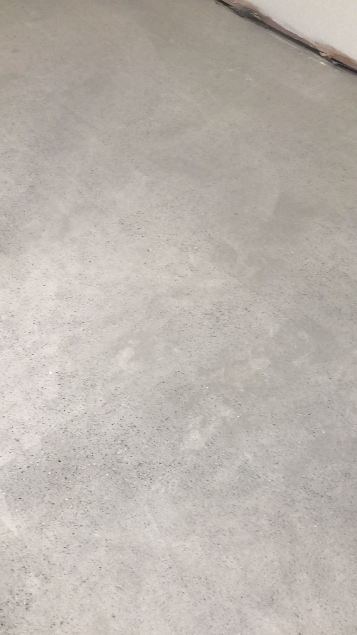

Three weeks later when the new kitchen was being fitted they noticed a loose tile and the tiler blamed the type of screed! All the tiles in or 30sqm meter extension are loose but the rest of the house is fine! The ufh was switched back on 10 days after it was tiled at a low level! Will upload a few pictures so can can get advice on what we need to do to solve the problem!! Thank you ben

Tiles that size need a perfectly prepared substrate. Are you sure the screed is cement based? Clearly the adhesive hasn't bonded to the substrate, whether that is because of the wrong primer being used or the screed needing sanding before.

The colours on your images are not very clear, it’s hard to distinguish between them.
The fact that the floor is immaculate and all the adhesive is stuck to the tile would suggest improper preparation.
Is there a thin layer on the adhesive that is a similar colour to the floor?
As if the adhesive has pulled a thin film of the floor up?

Was your floor sanded before the floor install?
Even liquid cement floors can need laitance removal first.
Yes it looks as if it had pulled a thin layer off the floor alright, I’m not sure why they used pva sealer on the floor! The house was 100% weather tight! All new windows and doors had been in place long before the screed had been poured! No preparation was done on the floor apart from being sealed!

The darker patches are surface laitance, you can not adhere to this, it will separate at some point.

If you expand the image you can see the aggregates in the screed, that’s what we prefer to see before sticking even a mat to it.
