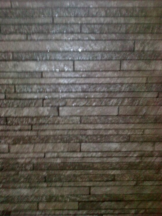

006.jpg 005.jpg these are the tiles mate, there a nightmare to work with, so getting someone eles to finish it isnt an option, and and its all very time consuming work.

Andy, I've used this mosaic tile before. It was used in a Premier Inn restaurant and it was all around the buffet area. The architect did not want them grouted. After some research I believe that these tiles should not be grouted! I also saw them in a McDonalds and there were not grouted. I think they should only be used indoors and only as a feature wall. I could be wrong of course. The grout lines are so tight (sometimes less than 1mm). I think it would be an absolute nightmare if you tried to grout them. However, if you do grout them I would make sure they are well sealed first. Cheers Sean

Andy they look like the Island Stone ones and yes they are a nightmare. But back to the point of your post, your really caught between a rock and a hard place so to speak. I know about delays only to well, something doesnt turn up and your at the mercy of late deliveries. I have to always now put a clause in, stating that the estimate is based upon the assumtion and understanding that the works undertaken are of a continuous nature, that acts as my get out clause. When the delays kick in, I pull this one out of the bag, which isent popular, but then they realise we have other work to do, and we dont take delays lightly.
Sean is correct, these tiles are not intended to be grouted, I would also advise that you draw their attention to this, if they have the installation papers that come with island stone it clearly states this (from memory but go onto the site to double check). To my mind you cant let down the other client who has booked you in to start, so you inform the first client that as soon as the trim comes in you will be happy to do a return visit to complete the works. They wont like it, but they ordered the trim, and should have been on the chase for it. Basically they are being unreasonable in their attitude, stand your ground and dont be mugged of. You may however be lucky and the second job gets put back a bit.

well john i have another tread going about sealer, it it seems to me some tilers feel they should grout them some say no , even there web site states some can be grouted, some not, none of it is very clear.
some back ground on the job............its a very big mansion house owned by a couple of american bankers who have employed an idiot, sorry i mean 'designer' to over see the complete refurbishment, my client is the plumber the plumbers client is the desingner and the desingners client is the owner of the mansion, we have been told not to talk anything to do with the job to the owner everything is sorted by the designer who is proberly getting paid a hansome sum of money to get the tile chioce right!!
i vioced my conserne about the tile to the plumber regarding the grouting ect as the jionts were very tight and i new the grout would be a night mare to get off. i will look more into it today and report back.

andy, are all the pieces the same thickness or are they random thickness? I assumed they were slate like the ones I've done before, hence random thickness.
sorry doug i didn't make it clear, there not slate tiles there porcelain, made by marazzi, the thickness is quite good, just very dimply to give it a natural look, the sealer i was going to use is a water based sealer you put on the tile and it washes off with the grout, its used for any tile ceramic porcs ect and just makes it easier to wash off, well its supposed to, ive never used it before.
any way, ive spoke to the plumber who spoke to the desingner, and he says there to be grouted so unless hes telling porkys to cover himself, i will grout them this week, cant wait :mad2:
