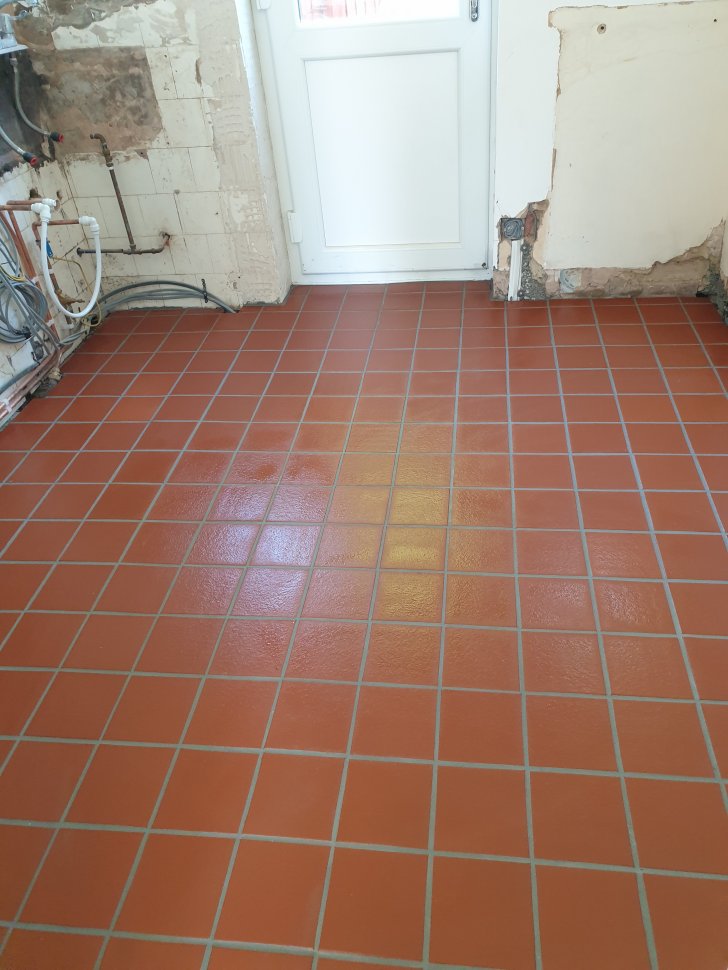

just tiled this floor, onto floorboards that were worse than yours using nmp... as it's all I could get during lockdown , and using the exact method I mention in my last post. the tiles were stuck down using bal single part fast flex, and grouted with bal wide joint grout with GT1 admix.
