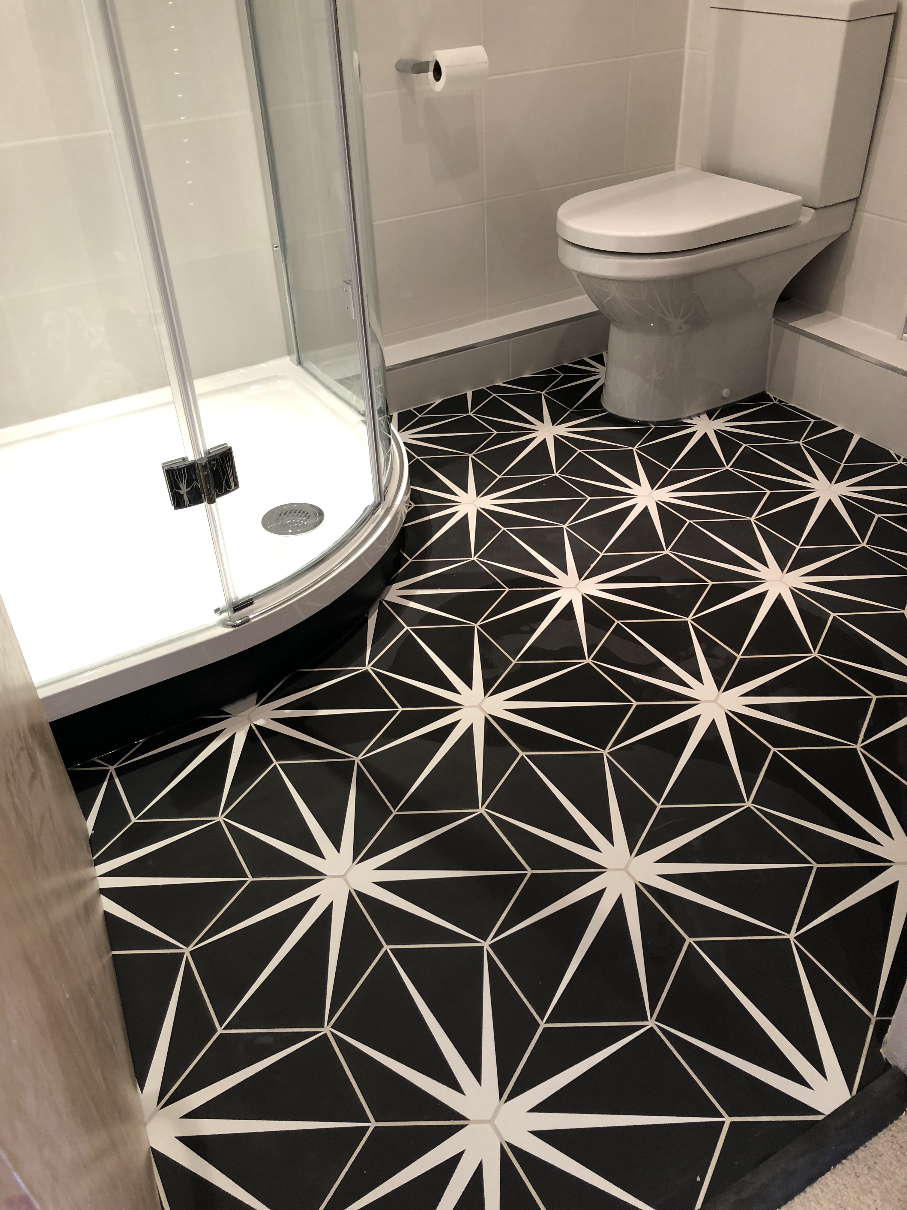

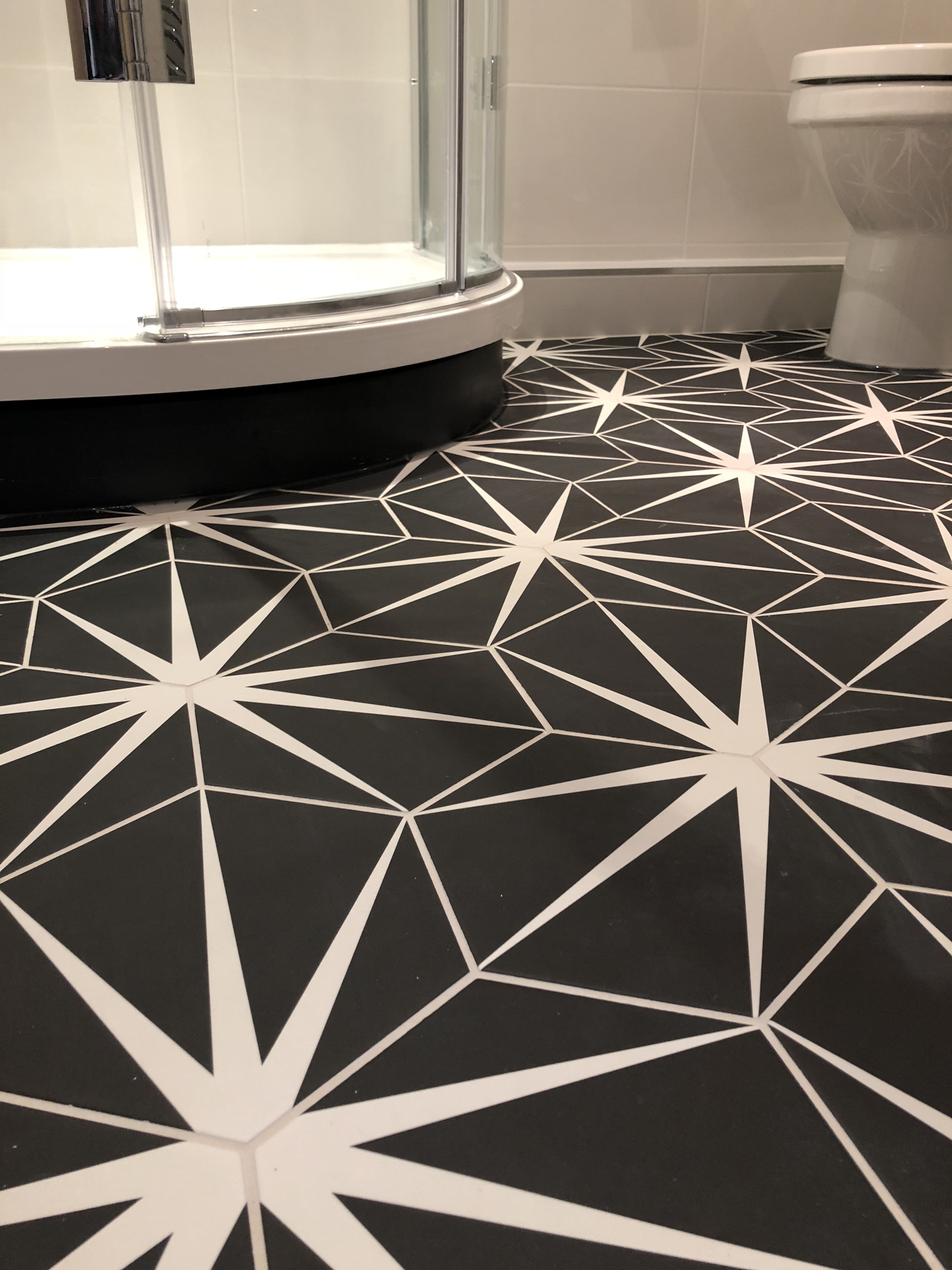

I prefer the top one. I’ve not done any of the tiles you have posted only these Lily Pad. They’ve been done with the top layout.
I think that's the best qaulity answer I've seen ever anywhere.
I reckon the grout lines form an integral part of the laid out design for these particular "encaustics". The earlier Victorian geometric and encaustic tiling was designed to be butt jointed but I would say these modern tiles were not. Certainly if you compare the photos of those fixed to the bathroom floor with grout lines and the illustration of the layouts it seems they definitely benefit from a well defined grout line.
