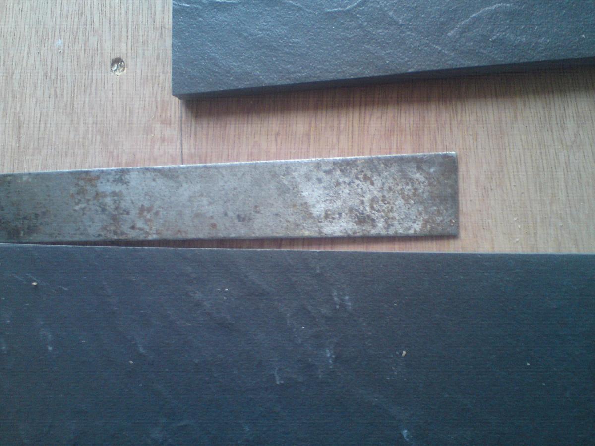

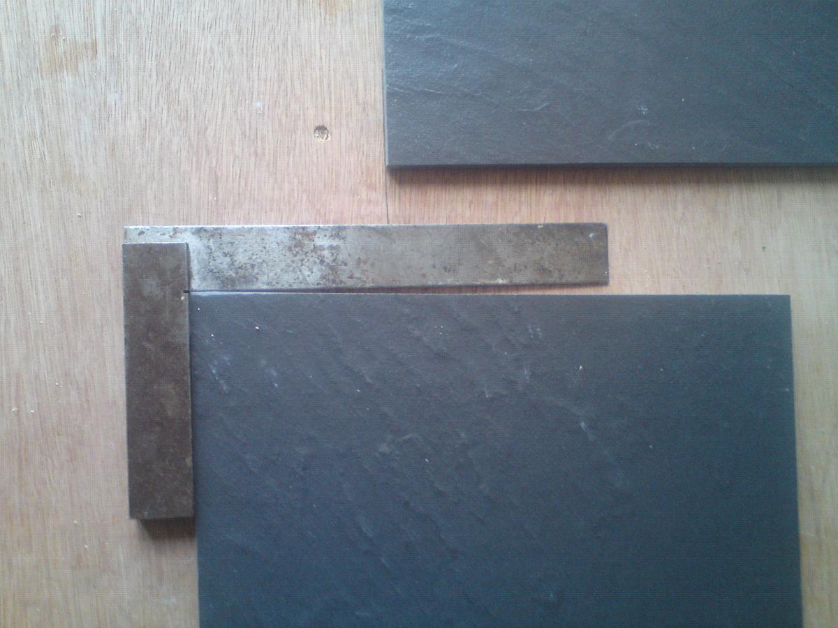

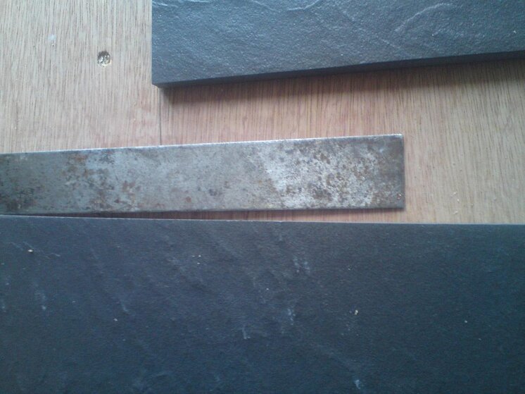

Started a job yesterday on an en suite (rather large 42sqm). Using a 60 x 30 beige porcelain for walls and floors with UFH going in. Anyway started tiling away yesterday, come to the third tile and there is about a 3mm difference in both height and width. Was sure every box was the same batch so i check them again that i havnt misread, nope all the same. Put a few more on, it was getting worse, one tile above the other with spacers either end and the middle of the tiles touched together the edges are that curved. Called the customer so she could see for herself, 6 tiles used and no way was putting more on the walls.
She called the place she bought the tiles from who then said they have never had this problem before, they will call her back. Called back and told her they think they know what is wrong, the tiler is using the wrong sized spacers, mmmmm Sure if i was using a 200mm spacer it wouldnt stop an object being a different size from another.
She has told them she is not happy and wants the tiles to be taken back with a refund, they are speaking to head office if that can be sorted. Meanwhile this morning, they have a tiling "specialist" who is going to call me and offer me advice on how this type of tile should be fitted, should be fun :)
Not a hand made product etc etc just a bog standard 60 x 30 that should be straight and of the same size.

Customer phoned me today, the company have checked the whole stock that they have stored, suprise suprise they have had to admit that things are not quite right. Woman is really really not happy, she has actually demanded a letter of apology is written to myself about the way i was spoken to, haha, may frame it.
Full lot is going back and she is buying from elsewhere.
