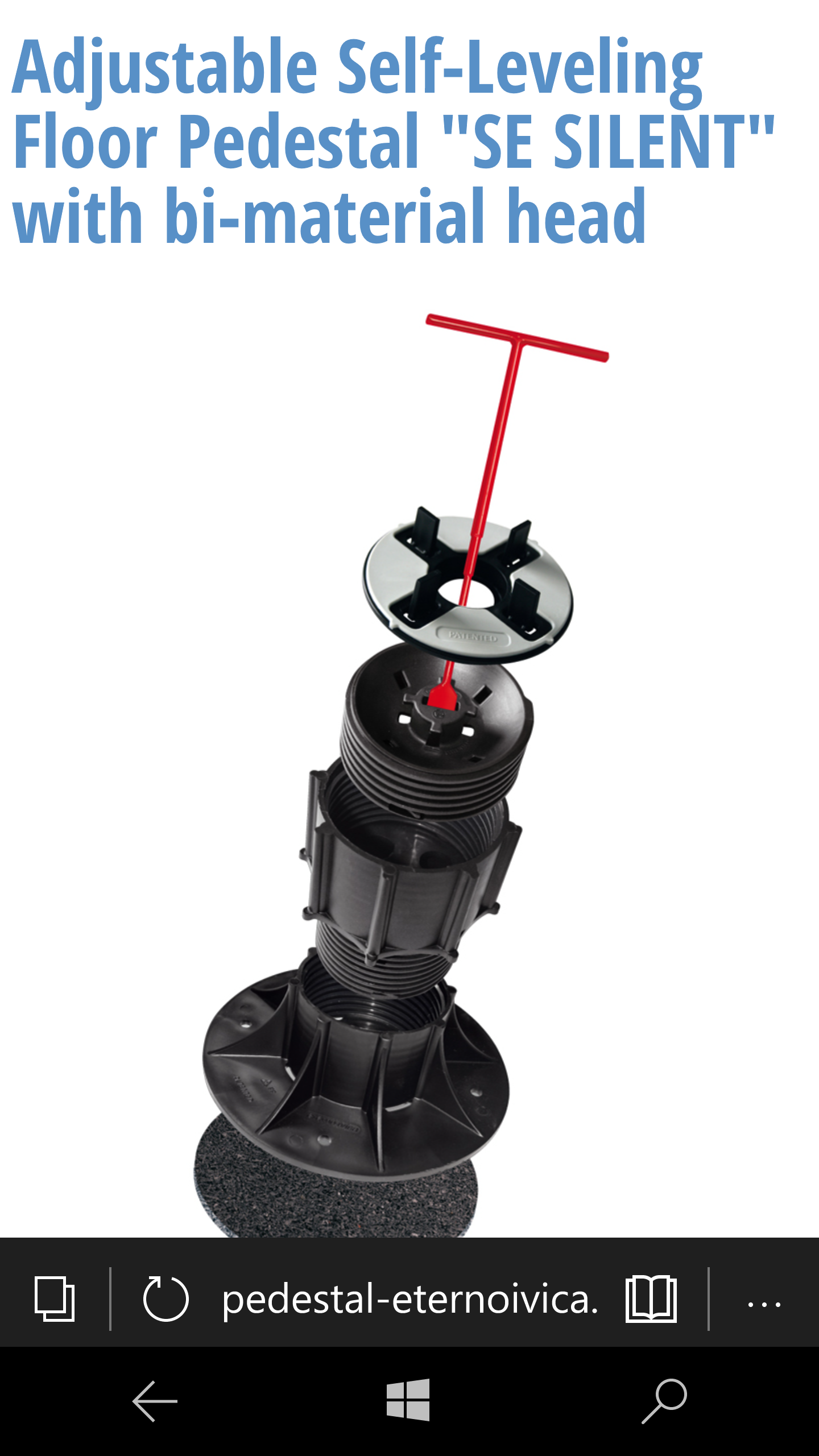

anyone tried these sort of thing?
Adjustable Self-Leveling Floor Pedestal SE Silent - http://www.pedestal-eternoivica.com/en/products/adjustable-self-leveling-floor-pedestal-se-silent-with-bi-material-head
