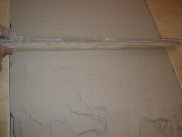

I use a couple of methods Lip.
First is fix the main tiles and cut neat tiles off a gauge to space the gaps where the mosaics are to go.
Then i can sometimes use 5mm Schluter Kerdi board to pack out the back and then mosaic over after.
Or, god how do i explain this.
Cut a template out of a cut piece of tile that has a lip sticking out the thickness of a mosaic, this lip should be the width of the mosaic border.
Run rapid setting white adhesive into the gap where the mosaics are to go and cut this adhesive back with the profile just made.
If its done right the profile will fill the border are with adhesive, but cut back enough adhesive so that once set you can stick mosaics flush with the thicker tiles.
I hope it makes sense.

This is one way using adhesive

Thanks for that mate, iv also tried something along the lines of ur first method, filling the gap with cut 6inch white but by doing this it can be to much therefore Iv had to build the rest ov the normals tiles right out which is a hassle to say the least. I lyk the sound ov ur 2nd idea which makes perfect sense mate, can't believe I never thought ov that!! Haha. Problem solved mate thanks a lot.
