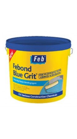

This stuff is good. FBBLUE10-250x450.jpgused it a few times and really bonds to porus or flakey surfaces.
I wouldnt use it to tile over be frank just interested to have a read of the product info. Was more thinking as a primer for marmox boards onto the painted wall for a better bond ?
