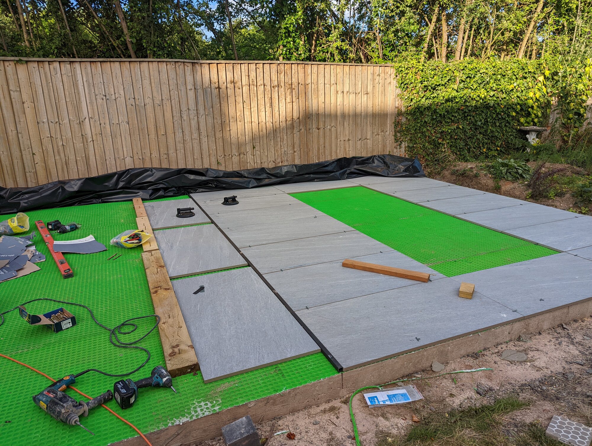

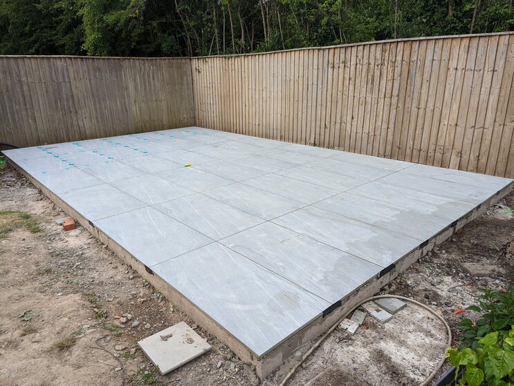

Hi I've just been through this exercise using 20mm porcelain 1200mm x 600mm to create a 7.2m x 4.2m patio. I’m a competent DIYer with some limited tiling experience. The Home - https://www.pavingexpert.com/ site is excellent and given the expense and effort I paid for a telephone consultation with Tony McCormack - money well spent. I wasn't confident that I could achieve the perfectly flat finish I wanted using mortar on type 1 etc and opted for laying the porcelain on a concrete slab and fixed with tile adhesive, I used Kerakoll products - isolator membrane, H40 adhesive and grout the Kerakoll rep was very helpful and were Pro Tiler Tools | We Sell a Large Variety of Tiling Tools, Tile Tool, Tools for Tiling, Ceramic Tiling Tool - https://www.protilertools.co.uk/
The slab was laid with a 1:100 fall and I used a Premtool levelling system. The finished result is fantastic. Please message with any questions.
