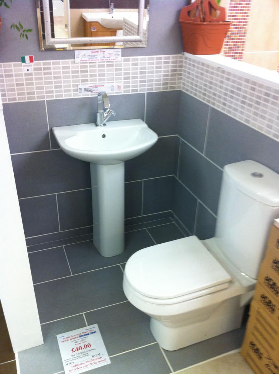

I'm planning the re-fit of our en-suite. It's approx 2mx2m and we're going to tile the floor and walls with 30x60 porcelain. We've taken a liking to these in the attached photo (from Avanti tiles in Milton Keynes - £40/m).
