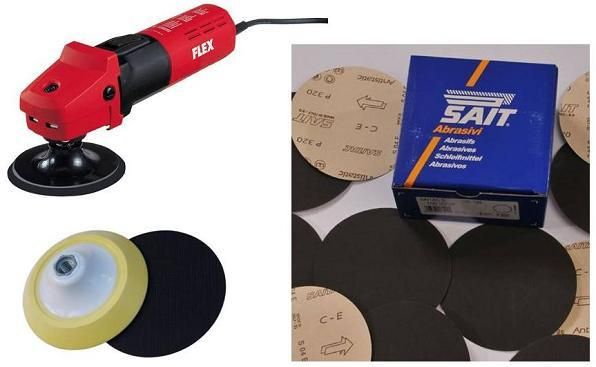

I've been shown it done using grinder with rubber backing and sand paper on face to make smooth the cut and round any corners etc, make the profile. Then hand rub with 240 grit - 320 grit wet. Then final buff up with cloth wheel on a polisher and some sort of wax. Wondering if a cloth pad in the drill will do the same
Concrete guy
Perfect starter set for polishing all sorts of edges.
