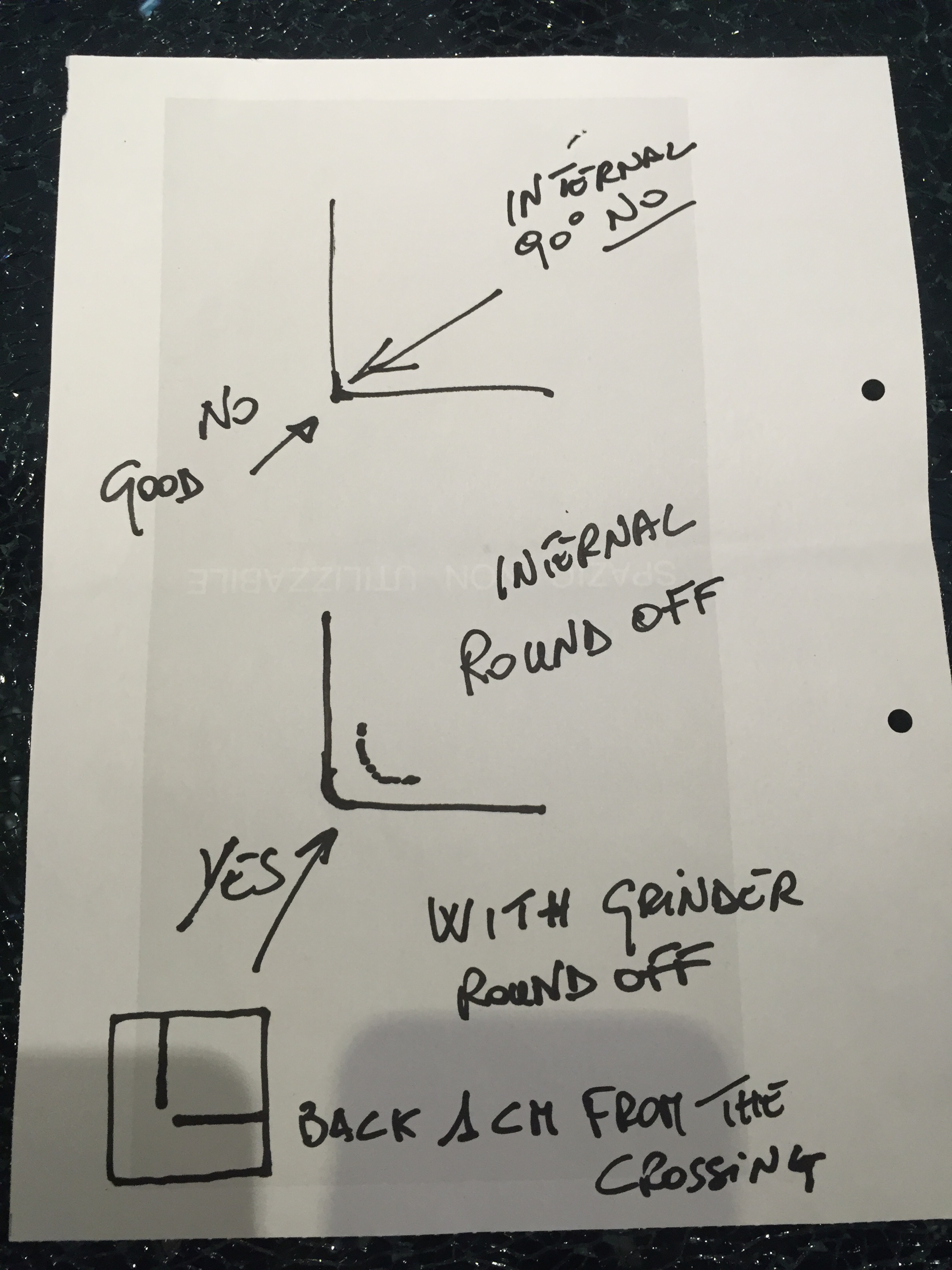

julian exactly.
pierce point intersection with milling cutter 10.8 mm :)
J Sid
I get that it's a stress point but do you think it is the quality of the tile that causes this.it could be very costly if it happens few years down the lines and can't get replacements and I was blamed for the cracking . I wonder how I would stand if a client tried to sue me .?it has nothing to do with the tiling in my view
I expect the quality of tile does not help, but as @antonio says, mill corner out to a radius or drill corner first with, say a 10 mm bit and cut to corner. This would be the 'material engineers' advice if you were to ask one.
This should done on internal cut on tiles, but who does it? I will use the grinder to put a radius in corner, lazy, yes! But have only had one go in may may years .
