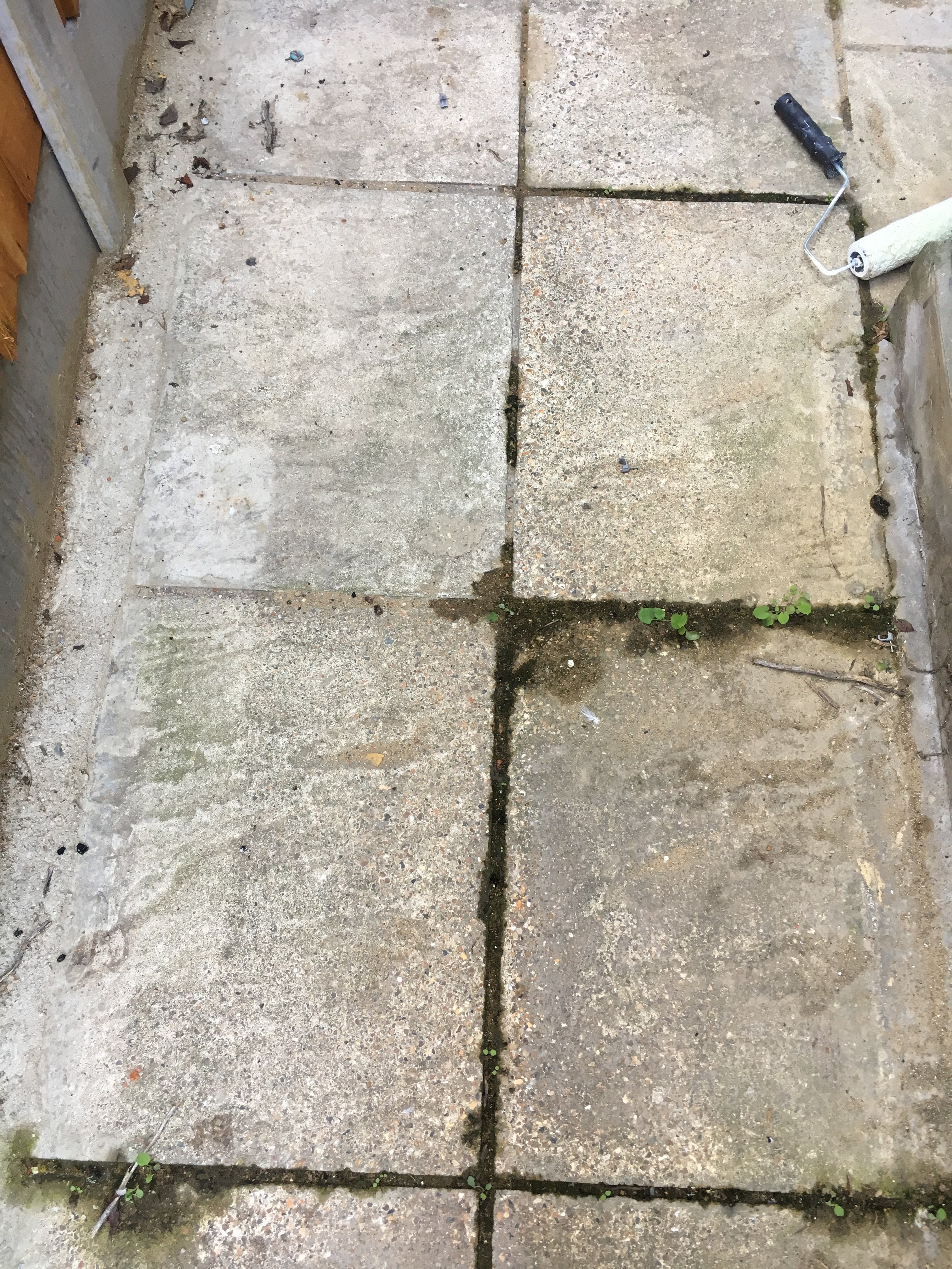

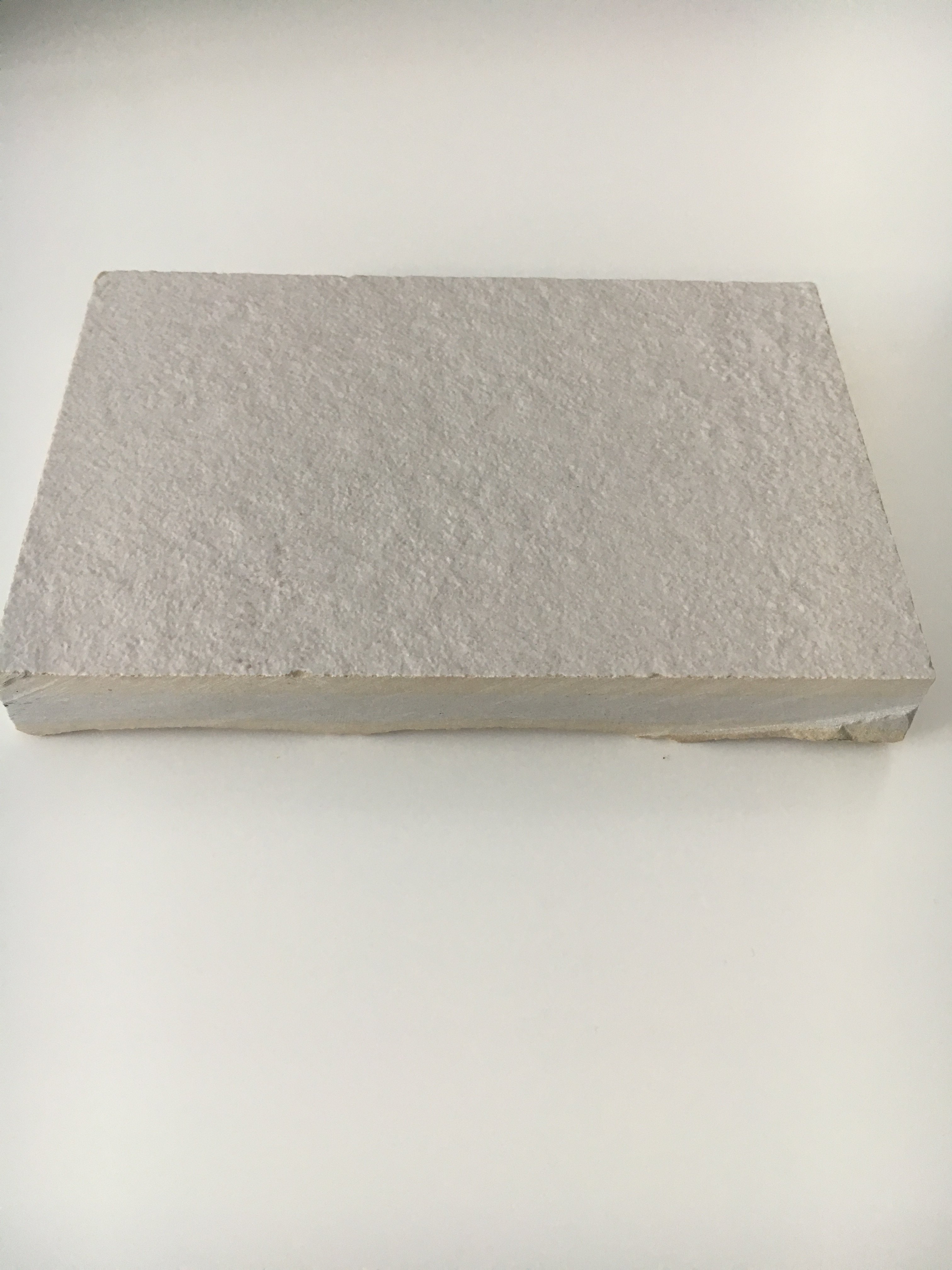

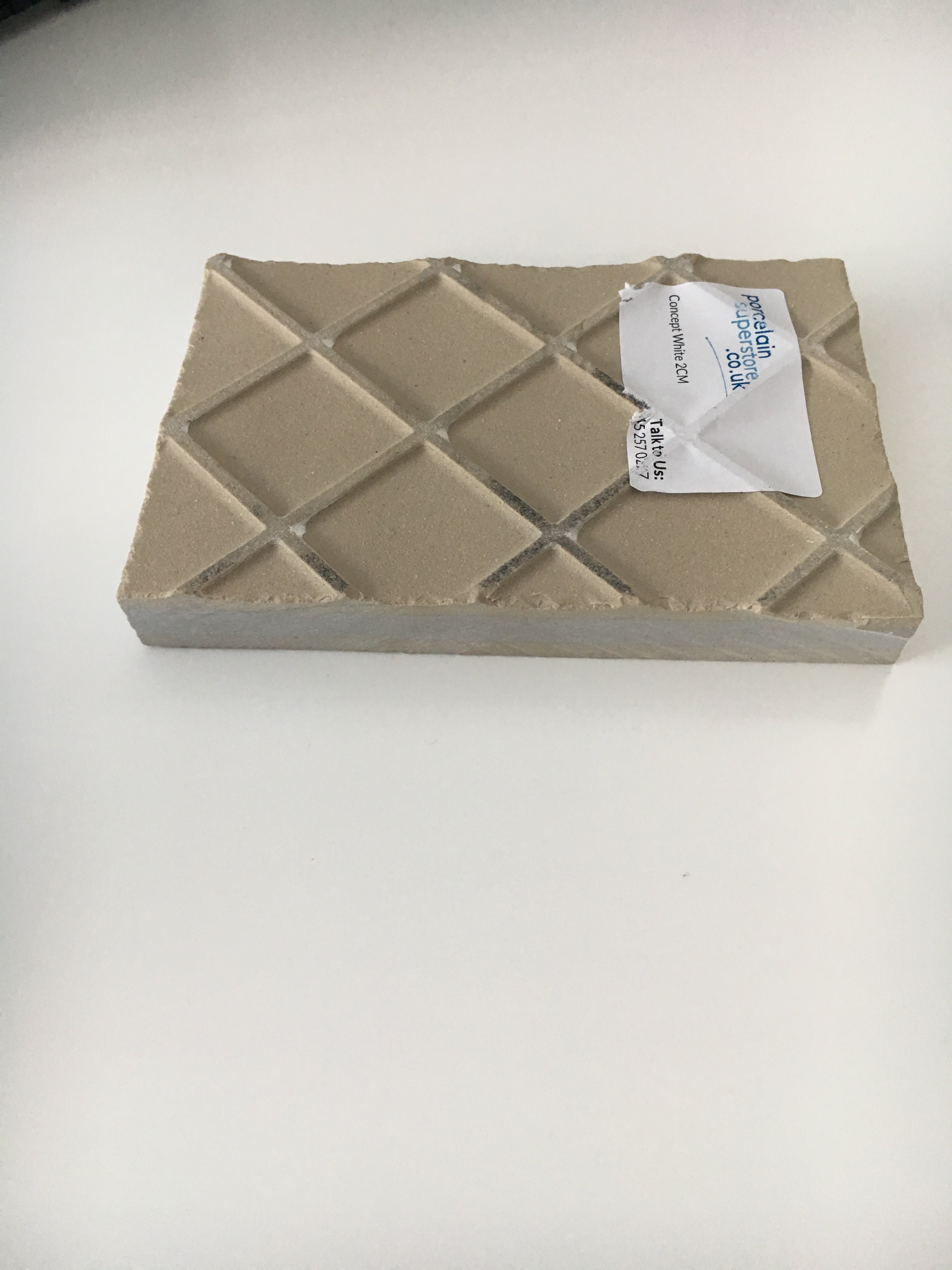

My patio is currently a patchwork of crazy paving, cement and concrete slabs (see pics below). I’d like to raise and level the floor before laying some outdoor porcelain tiles (pics below). I’ve found a builder specialised in paving who wants to do the job. He says he s going to screed the floor and lay the tiles directly onto it and get the job done in 3/4 days (20sqm). I was expecting a more standard concrete slab and tiling with adhesive.

Porcelain needs an additive to bond to a S/Cement bed.
Some of the 20mm porcelain now being marketed for outside areas comes with its own additive, or as Harry suggests, an sbr slurry can be used.
There are a few different ways it can be done, depends on your fixer and what he prefers.
It is possible tho.

So...youve found a builder/groundworker who specialises in paving but you don't trust him... says everything to me... get a proper tiler in who knows what they are doing.
