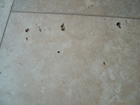

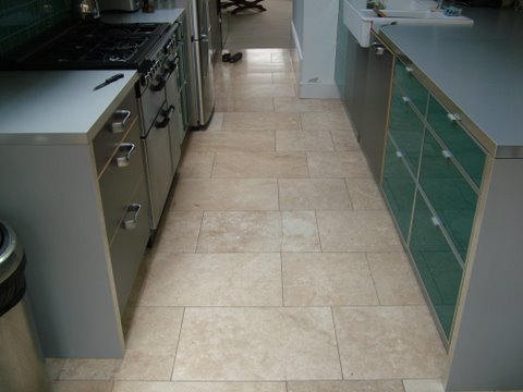

I would appreciate any advice. We had our hall and kitchen floor tiled in travertine Christmas 2006.
We have got two problems:
1. Some of the tiles now have potholes in them. it is like the fill that has been used in the manufacturing process has given way and a pothole has formed. It is not as if it is all in high use areas but seems to be very tile specific. I want to go back to the supplier but would appreciate any advice on anything we could have done to prevent this. i.e should we be re-sealing evry six months or any other specific care?
2. We have some pretty seriously cracked tiles. The main crack seems to run through about five tiles and will sometimes miss a tile and go through the grout and appear on the next tile. We are going to have to dig them out and replace but I want to know how to try and stop it happening again. The cracks do not follow the joints in the plywood underneath.
There are a few things that are of concern here! The first is the potholling as you call it.
Is that restricted to one area or all over?
Secondly the cracks are there any chances of getting better pictures posted please? you can email me direct or post on here!

Looks like it could be inadequate coverage/lack of back buttering in terms of the potholing.The cracks are just showing whats going on underneath.
Through the holes, can you see the adhesive, or just more stone. If you can see the adhesive, then the fixer hasn't back buttered the tiles. If its stone, the you have a problem with stone quality. With this stone you have little pockets in the stone, the lower the quality the more holes. In my experience there's not much you can do to avoid this happening.
The more worrying this is the cracking.

The PVA primer thing has got me concerned, It does seem to be in favour with some of the fixers around. It SHOULD NOT be used as a primer or admix in glues and grouts because it will break down in the presence of alkaline compounds forming acetic acid not something you want around stone. Could be the cause of the patchy pinholes in random areas of the stone.
The cracking could also be caused by the adhesive coming in contact with the pva or worse being used in the adhesive mix causing the glue to partially fail in some areas and not in others.
At best a simlpe remove and replace and regrout of affected tiles.
At worst a complete stone floor failure and I think you might know what comes next.
