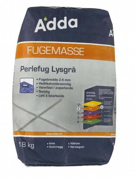

Hi, It looks like its made by 'Adda' and is described as 'Fugemasse Perlefug Lysgra' in a light grey colour and from the details that i can make out it's suitable for joints 2-5mm. I used 3mm spacers so it should be ok in that respect.

Can you post a picture and ask our kind Norweigian friend to explain any language we don't understand.
10th of March could just be the bathc production date. OR it could be the shelf date. If it's the later then the grout was past it (or best part of) when applied. That being the case there's some responsability from the suppliers. Certainly if it's a DIY shop and not a professionals outlet.
Worth investigating either way as if the products not fit for purpose your sisters pocket remains untouched to get the issue resolved.
Yeah that's a good idea. I'll try and get a picture of the bag on here for our Norwegian friends to advise.
Thanks
Fug 2.jpgIs this the culprit?
yes that bag is indeed the exact same product. I guess you can now confirm we bought some poor quality product??
