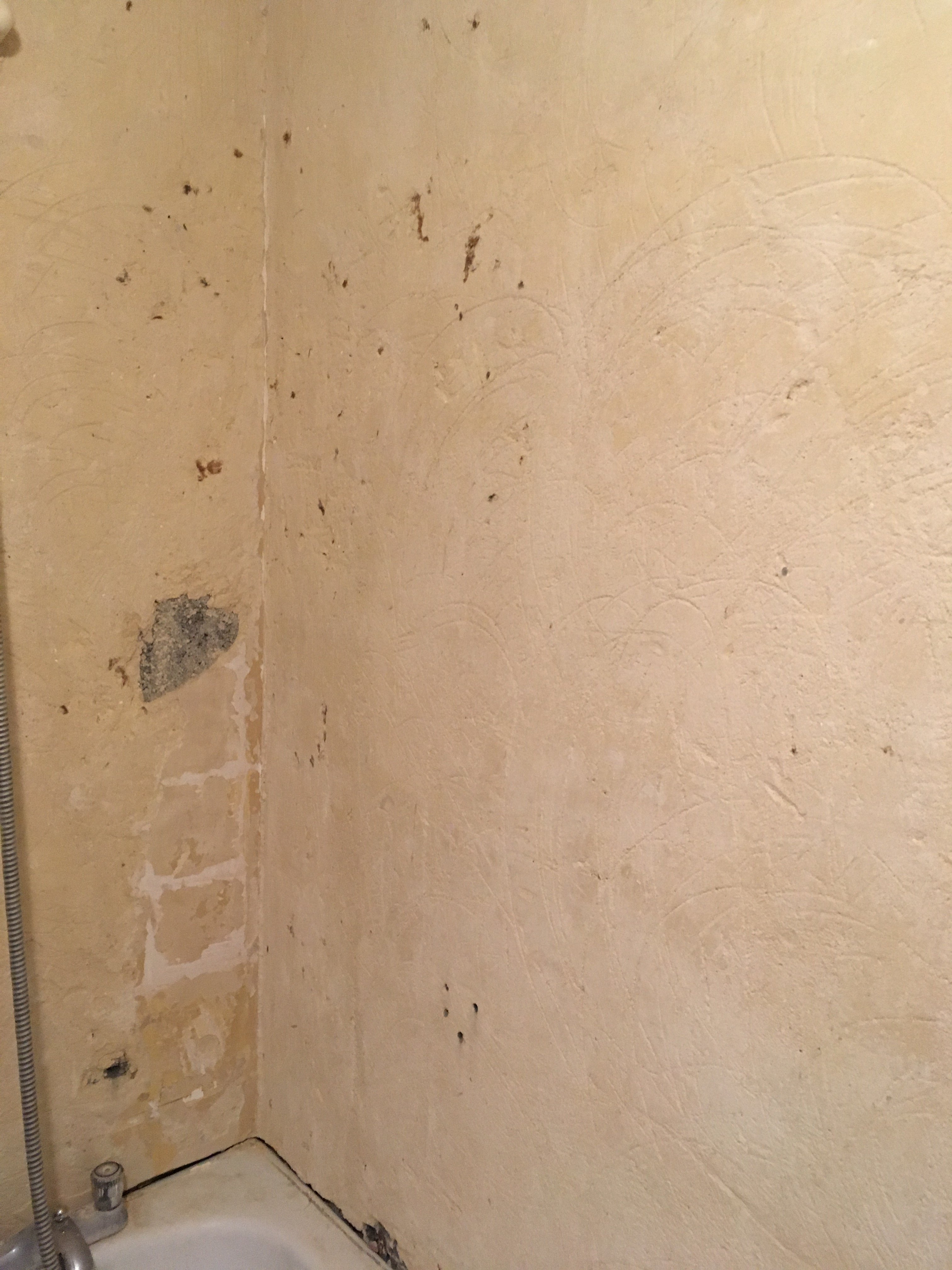

Removed old tiles in a bathroom. New 60x30 porcs to go on. Plaster skim came off with odd tiles, so left with bonding coat (pic 1). Done some research and found that one shouldnt tile onto a bonding coat (2reasons: sucks moisture from adhesive but even if you thoroughly primed it hoping to alleviate that problem, the adhesive setting it can actually destroy and pull away the surface of bond coat because the bond coat is not that strong). Will be bordering weight limits with a skim coat, and also dont want to wait for it do dry if a better alternative. So will be tile backing the walls which will address both points. So far so good i hope, but please critique as needed.

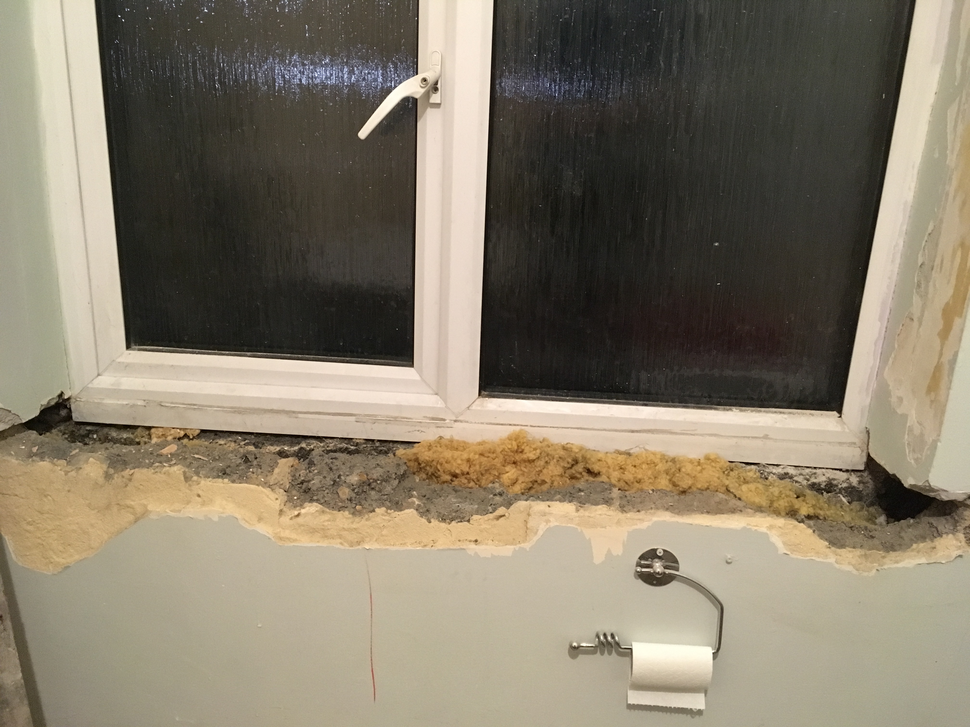

Then for window sill (pic 3). Bit of a mess. What do i do here? Not sure there is quite enough space for any framing to fix backer board. What other alternatives are there to square it up? Do i use: mortar, tile addy, bonding coat and skim, or multi finish coat?

I’d knock all the render off and use a combination of plasterboard and tile backer board. Both dot and dabbed, tilebacker board also mechanically fixed.

Window, same again- dot and dab a board on. It’ll take a tradesman two days to knock all the render off and re board the entire room. Two days we’ll spent IMO. Horrible job but getting this done right will be the best possible course of action. Otherwise if you leave the render on, the whole job will be starting on a compromise.

Thanks for that. I did contemplate taking off the render, but wasnt sure how easily it would come off, so didnt want to start and find it was well stuck and not necessary to remove, but only after having left a a hole. But if boards are mechanically fixed on anyway, that will go though to the block behind, so wondering what added benefit you see to removing the render?
Removing the render you will be fixed to block with the bonding adhesive not the render (which may come off) less weight on the walls overall as well. Also gives you more space for getting walls plumb.
ok, not saying you guys are wrong, but some of the reasons for removing render arnt adding up. Im not implying Im going to just do my own thing regardless, or else i wouldnt be asking advice here, so please dont be offended by my debate.
Agreed, if i was adhesiving the backer boards on then fair enough, cant do that onto the render, so remove it. But I intend to mechanically fix boards to wall. Dowel is 60mm, backer boards probly 10mm and render about 10-15mm, so that leaves say 35mm into the block. Seems ok to me; would you consider that insufficient? And as to reducing weight on the walls, shouldnt matter if boards mechanically fixed into block behind.
Wrt space, yes taking render off would save 10-15mm which id like, but the work involved taking it off doesnt seem justified. I tried taking it the cracked wall, and its a job- doesnt come off easily.
Agreed, would help to see cracks, but im happy the longer wall is not badly affected. The other wall with cracks, is the one i tried to remove it from and have mostly, but like i say, didnt come off easily 🙁
You can absolutely leave the render on, there’s no reason why not. Keep in mind you are adding a healthy 18 to 25mm + to every single wall in the room depending on how Plumb the current wall is. For example if one of your current walls tapers away from you out of level from top to bottom by 15mm, by the time you have corrected that there might be 40mm thickness of board where your bath/shower is going. I hope that makes sense.
