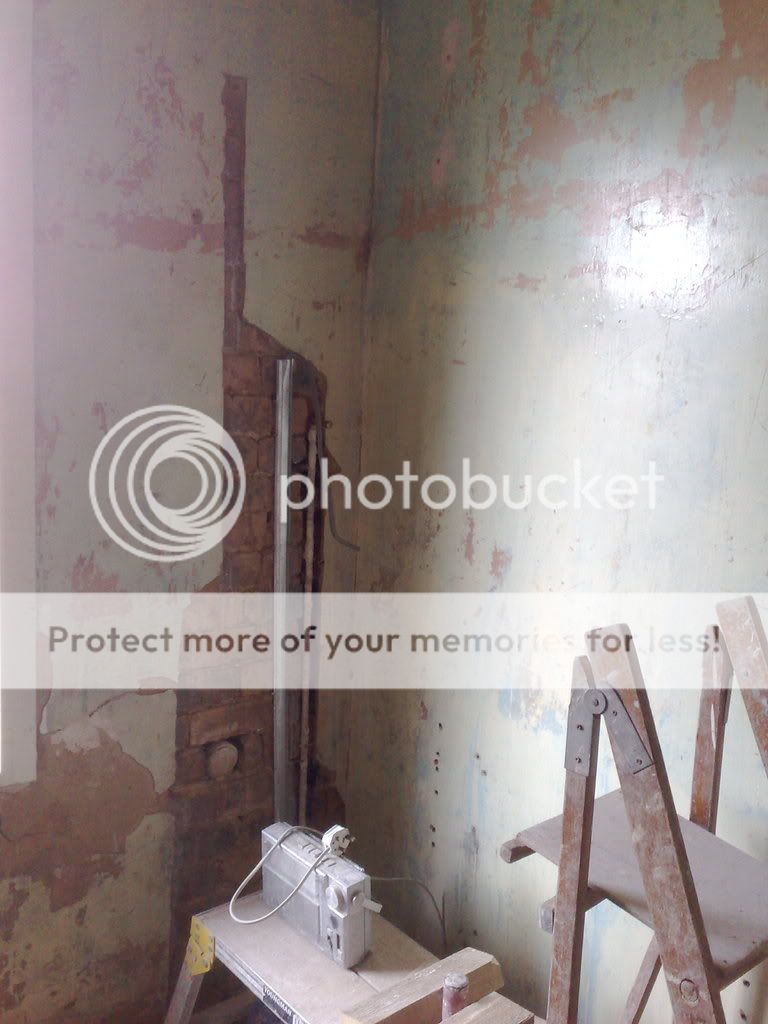

My bathroom is being "renovated", using Travertine tiles on the Walls and Floor. The total area is 40 sqm or so, including a full bath surround.
I can post pictures if you like.
The walls are Brick with mostly old plaster finish, a fair number of places have been repaired by the plasterer. 3 places are plasterboard fitted to battons, the airing cupboard the old chimney breast and the bath surround.
The plaster says he is going to skim the new plasterboard and repair any holes in the current, old plasterwork. He does not intend skimming the old plaster.
The floor is std 22mm Floorboards (Older type) covered with Marine Ply.

In walking round the room as it is I cannot see any big deal in doing that, I am pretty sure the plasterer ain't gonna be happy? Would he expect it too be off for him?
The job is being done by a local firm, they've been around for years and were recommended to me, funniliy enough their quote was in the middle of 3 we had done.
We did say it was Travertine, 30kg sq/m etc, I assumed they would know, but perhaps they do not.
It is a fixed price job, I am going to get my wife to ring them now if she can.
You're right to ring them first and ask about the removal and tell them about the dry lining.
You don't want them disappearing on Monday for more materials, and forgetting to show up again ;)
Is that just wooden surrounds at your window?
If so I would take them and the sill off too. You'll get a much nicer finish with them away.
