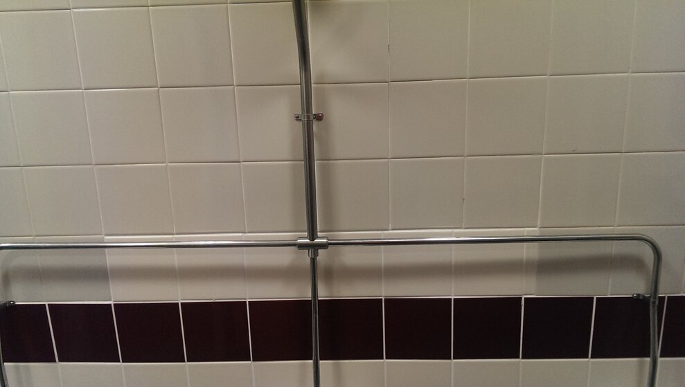

We could dedicate a whole thread to pub toilets. Pretty sure they cop most of the worst tiling!

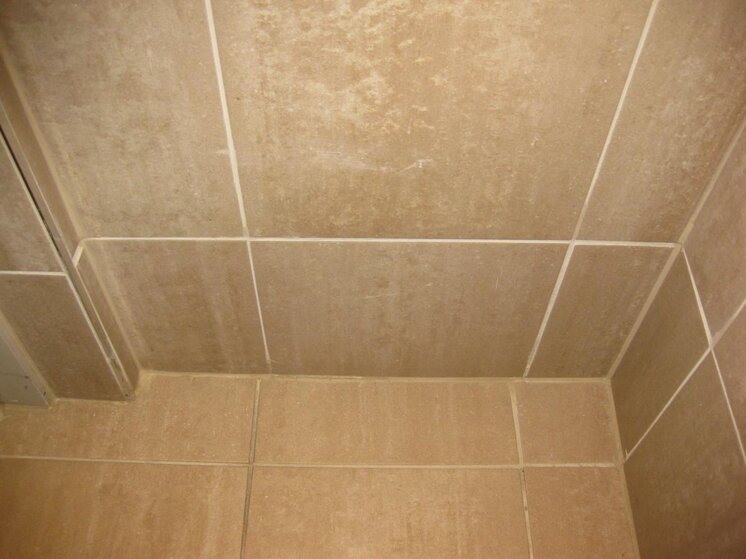

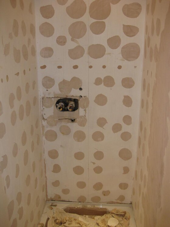

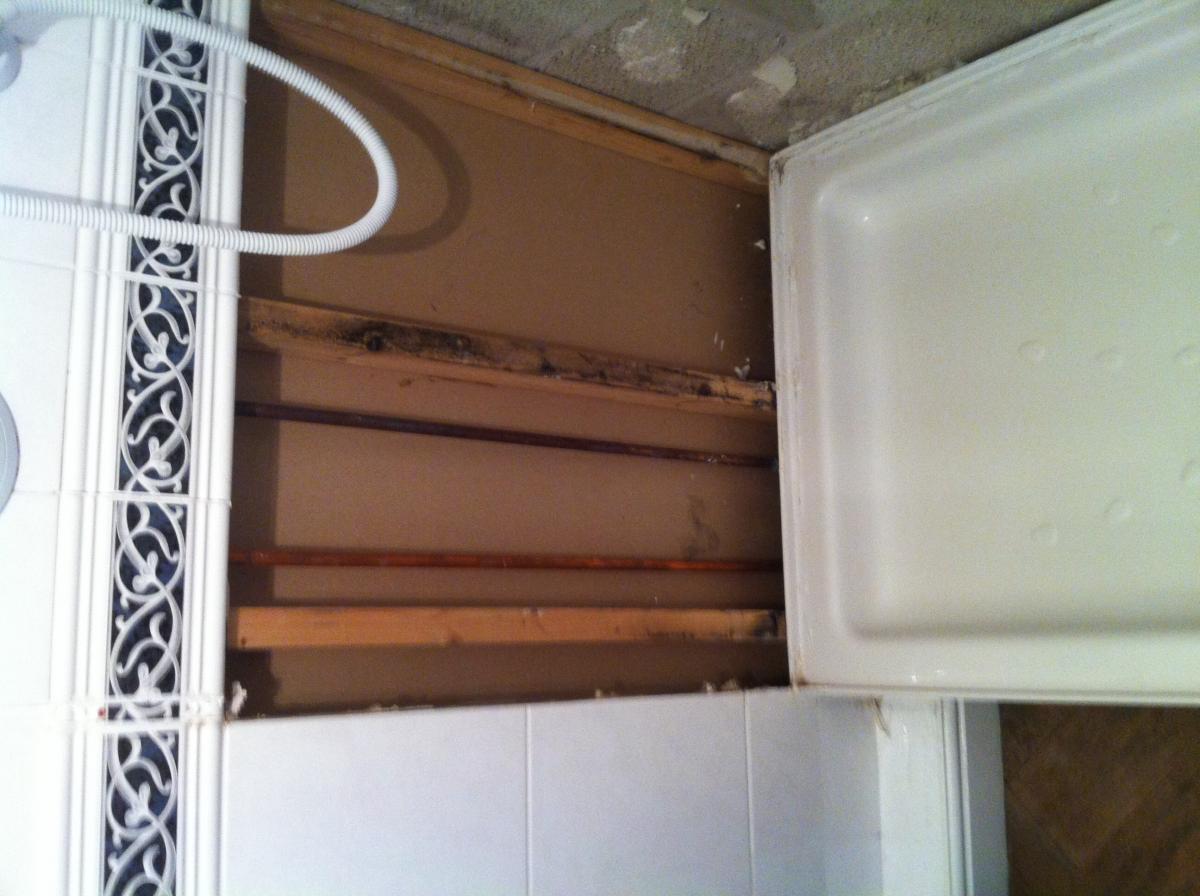

Just been to look at a job. This is a bathroom that was completed just before Xmas 2012, all work carried out by builder.
No silicon between tray and tiles just grout, no silicon between cubicle frame and tray, massive gaps around edge of room filled with grout and then covered in parts with silicon. 1 tile running at 90 degrees in front of shower tray to rest of floor. Notched out tiles where pipes are. joints up to 15mm where walls meet. Tiles not following profile of shower tray. Grout cracking and popping out of joints.
View attachment 50558 Bath1.jpgBath3.jpgBath4.jpgBath5.jpgBath6.jpgBath7.jpgBath8.jpg

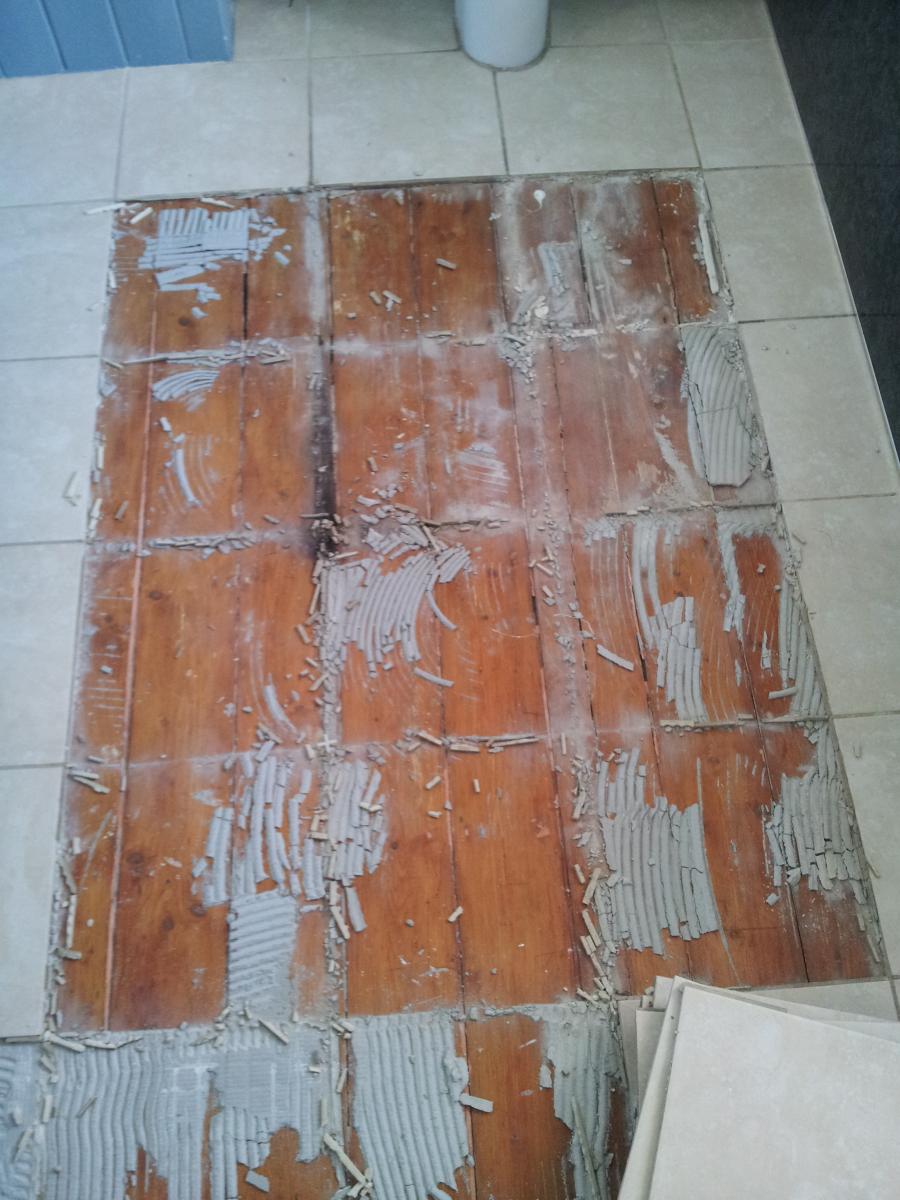

are the floor tiles loose as well..? looks a right mess, still it lasted nearly 3 months, thats a new record for a builder...:lol:

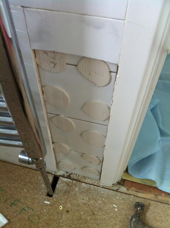

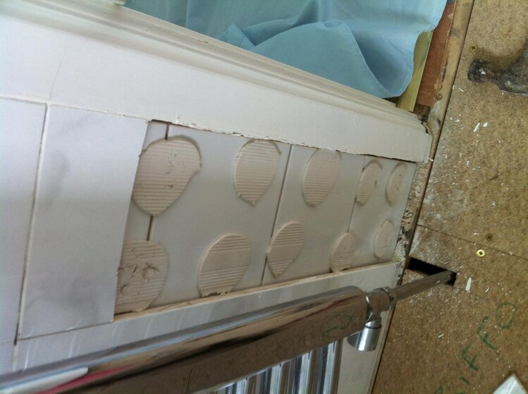

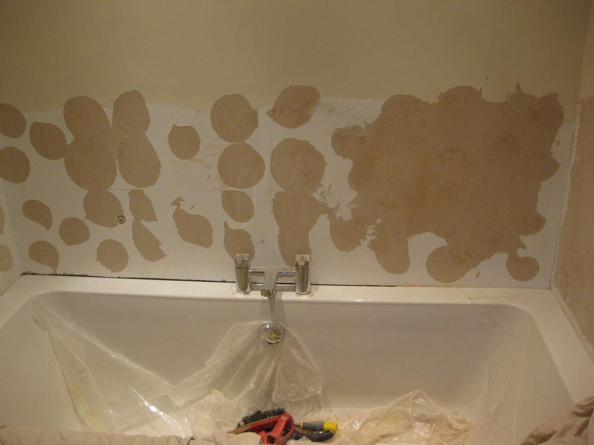

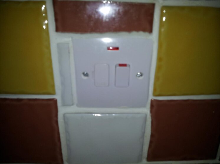

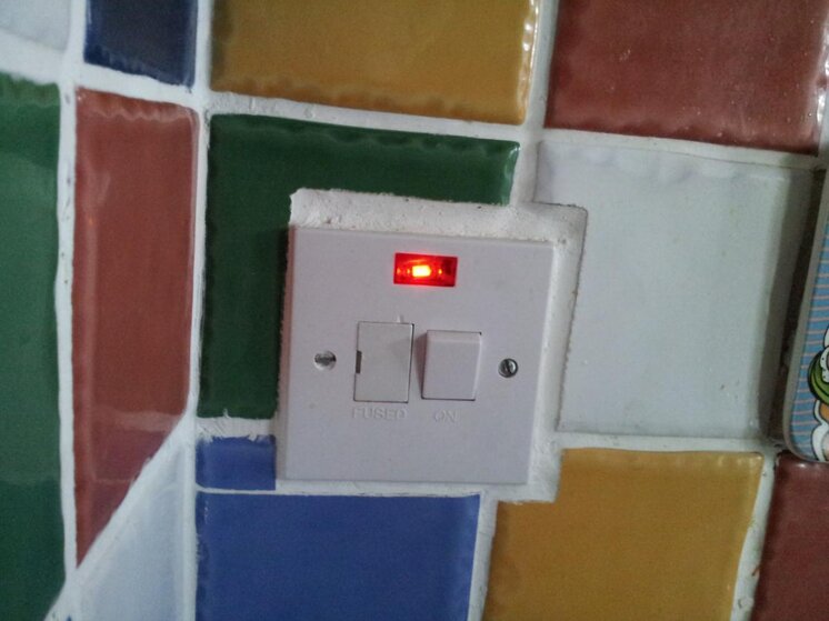

Here's a few ...."Tiler" legged it when a second opinion was requested:
This guy even had a cracking website lol...Pitty about the waste of porcs ! Only bonus was the majority of tiles had been
stuck with tubbed so were easily removed & cleaned. Check the swerve it thw mosaic shower run !!!
