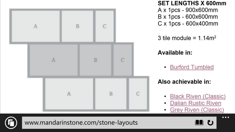

I have a job to quote for in wot they tell me is "Queens pattern"
900x600
600x600
600x400
Grey limestone 20mm thick.
Cannot find patterns for this? Has anyone heard of it......or does anyone have a link to any pictures?
I have looked at most of the online pattern pages, but no luck as yet?
Cheers muchly.
I'm a tilers (they say) .....
not stoners
stoners know that is wrong
basically tis is a 600 wide tile laid bonded with varying lengths don't think you can lay it in a square opus type pattern with only these 3 size tiles
Think u sussed it @wrighty
It's 9x6
6x6
4x6
It's a running broken bond is t it?
Every other pattern I can think of, or find, with those kind of size ratios has another small square piece.
The customer has a pattern that came with the tile......but he hasn't had them delivered yet......I just thought I'd see if I could find other options.
If the small tile was 600x300 not 600x400 opus could be done by cutting small tile in half
