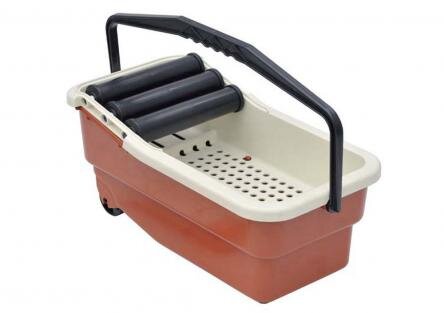

Ive got the one without the squeegee thingie, still a superb bit of kit for floors , and yes it saves your back and knees .
I bought the Rubi squeege system and it worked great as long as the grout isnt to stiff. Not sure of its life span though. I think i will take the chance on the Pedalo.
Just gripfill a broom handle head to a sponge float and stick a broom handle on it , works for me.
I use it on open areas of flooring , works a treat and cost virtually nout.
Diggy :0)
I've had one for about 5 years now. Great bit of kit on the right job. I tend to only use it on floors 40m or more. It takes around 3 yellow builders buckets to fill it with water and although it has wheels, it's a two man lift to get it back outside to empty it. I would recommend getting the sponge with the one solid pole. I had the one that joins in the middle but I found it to be a weak point when leaning down on the pole to wash and it's not easily dismantled if you were thinking of saving space.
Hope this helps.
Same as above.you can't lift it over door thresholds on your own so you need to work out where you your going to empty it before you fill it.I tend to use the washboy for the first washdown as the pedalo doesn't quite rinse enough of the water out the sponge but it definitely saves the oLe back on the larger floors
It is heavy when full, but us young lads should be strong enough to lift it 😉
As for the cleaning , I find it cleans really good ,without leaving much residue on the tile, like I said above I don't have the posh one ,but I squeeze it out under the rollers,and it works a treat 🙂
I asked about these on here a few years back and that's the advice I was given. I still tried to use it on a car showroom I was doing at the time and sure enough it didn't last long
I'll make sure I've got a spare handle on stand by for when the inevitable happens.
Anti foaming agent sorry
Mine went after about 2 months, and it was the 8 stone numpty apprentice who did it, he was probably leaning on it looking a gay **** on his phone the little ####.
Luckily someone said on here about the handle so I had a spare broom handle in the van 😉
Works ok for bigger floors (30m2), on larger areas we use washingmachine.
But to get the real finnish we allways tend to use the good old washboy
