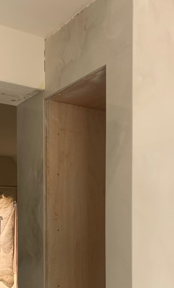

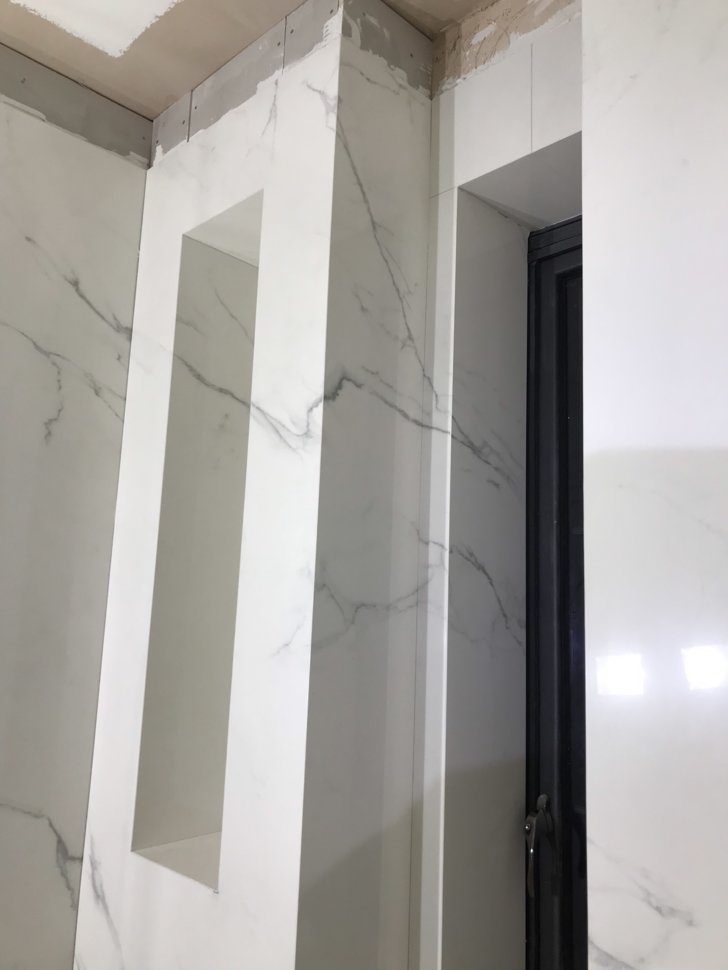

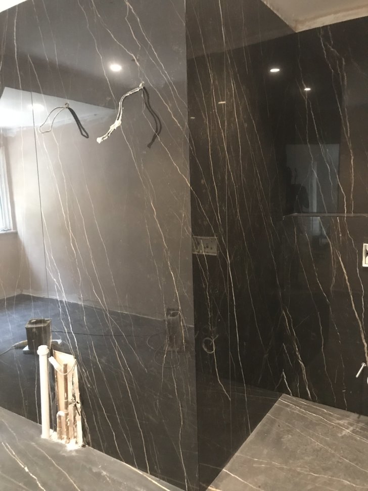

I am doing mitred external corners. They have come out really nice using a grinder. I have left about 2mm edge on the face.
I’m planning on filling with resin. Where do you get it from? Should resin colour match grout or tile.
If you have any finished pics of your work that would be great.
Many thanks.
