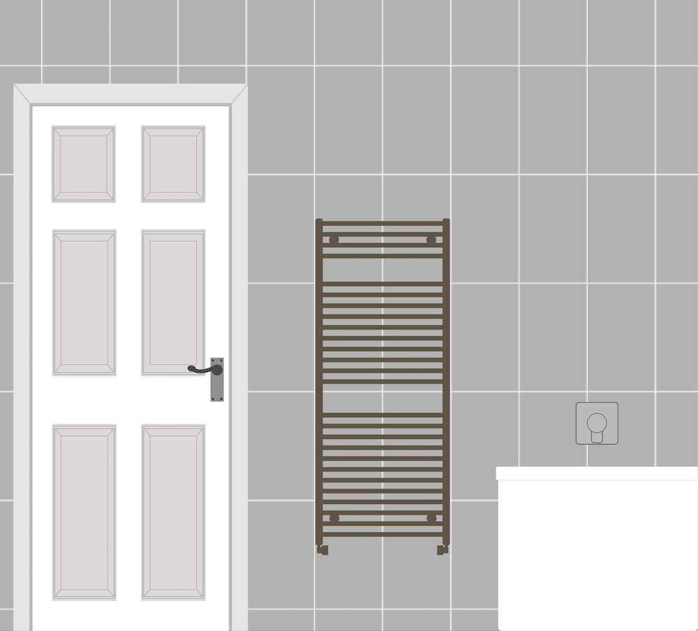

So, without further ado, I would like to show you some images I have prepared and would like to hear what you think.
Well it appears to work.
On a personal note, intergrating mosaic in to a tiled bathroom for me isn’t something I’d do, I feel it’s a very dated feature and can tire quickly.
But that’s only personal opinion.
Had you considered having the mixer in the centre of a tile?
Is there a specific reason you must have wall opposite the door mirror that one?
Doesn’t matter, it’s purely curiosity on my part.
The door wall is effectively behind you when you enter so can’t initially be seen. And even when facing the mirror wall or opposite, you can not view both small walls at once. Hence my interest in your set out.

The mixer is centred to the bath but the tile set out on the feature wall (opposite) dictates the mixer cannot be centred to a tiles/tiles without changing the tile set out on the mixer wall which I don't think will look right.

I thought you might comment about the height of the first row of tiles above the floor - this seems to be the only way I can avoid a horizontal grout line above the sink. I see this as a viable compromise but I don't know whether this would be acceptable to a professional fixer.

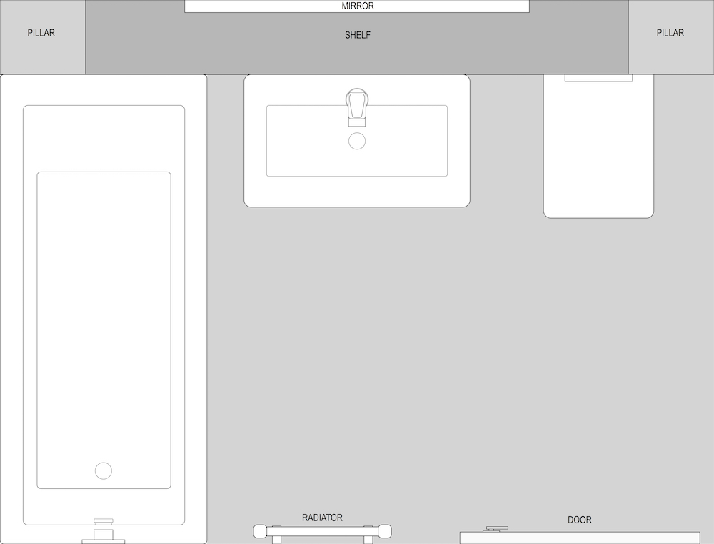

I have also prepared a scaled drawing showing the 'plan view' of the room for reference purposes.
You plan view helped thank you.

As far as bottom row goes, I don’t think it’s iffensive at all.
I don’t tend to walk around with my eyeline at the floor. 🙂
It’s kinda skirting height anyway, so perfectly acceptable in your circumstances I feel.
In certain instances, you are correct, it wouldn’t be.
I might consider a larger mirror if it were me, to deal with unwanted grout joint, possibly.

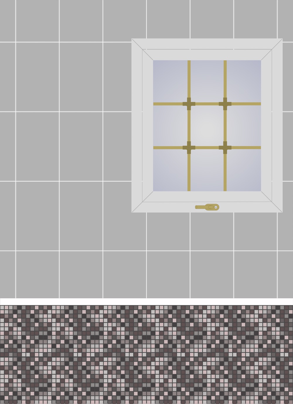

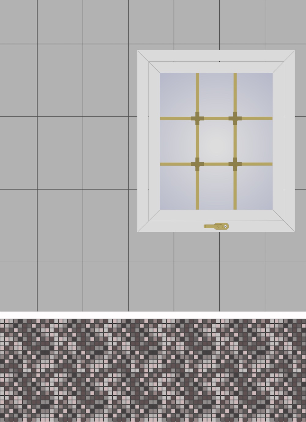

.... today's dilemma!
Looking at options to tile around the window.
The tiles to the right of the window and above the window are dictated by other considerations.
Therefore, I am only trying to decide which is the better choice in relation to the tiles immediately to the left of the window:
Option 1
Pro's
Avoids a narrow cut to the left of the window
Con's
Tiles going into the corners of this wall (and the wall opposite) will only be approx 8cm wide
Option 2
Pro's
1. Tiles going into the corners of this wall (and the wall opposite) will be much wider (21cm )
A more even array of tiles horizontally above the bath.
Con's
A narrow cut (8cm) to the left of the window.
Gentlemen, your opinions please...
